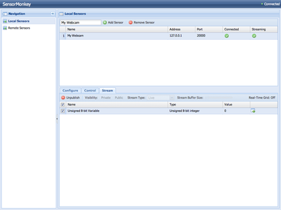

Step 4: Login to SensorMonkey and Publish Stream for Controlling Arduino
You can login to SensorMonkey using your existing Facebook account by clicking the 'Login with Facebook' button in the top-right corner of the page.
You will be prompted to grant permission for the SensorMonkey application to access your Facebook account. Once you have done so, you will be assigned a personal namespace (a streaming 'sandbox' for your sensors) as well as public and private keys to access your namespace from within a webpage. You will need your private key for Step 6. You can find it by clicking the 'Namespaces' link at the top of the page.
Once logged in, you can access the web-based control panel through the 'Sensors' link at the top of the page. The control panel is where you will connect to the Arduino and publish its stream live over the Internet.

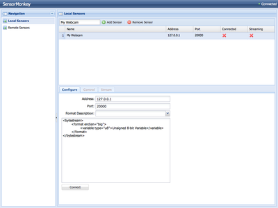

After logging into SensorMonkey and opening my control panel, I'm going to add an entry for the Arduino named "My Webcam". By clicking on the newly added entry, I can configure the connection parameters; namely, the IP address and port number where the device can be found.
Recall from Step 3 that I am using Bloom (or SensorMonkeySerialNet) to map the Arduino's serial port to TCP/IP port 20000 on my local machine. So, I enter a port number of 20000 and an IP address of 127.0.0.1 (the local loopback address). I'm not reading any data from the Arduino, so I can use the default format description file provided by the control panel.

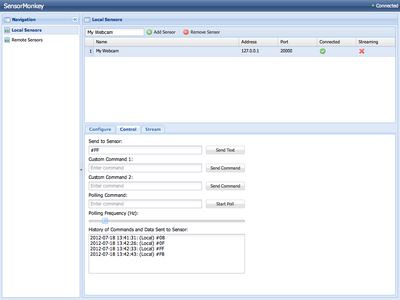

After clicking 'Connect', I navigate to the 'Control' tab where I can test my pan and tilt assembly by sending commands to the Arduino. By prefixing the commands with a # symbol, SensorMonkey will interpret the text as hexadecimal character pairs (i.e. binary octets). So, for example, I can instruct the pan and tilt assembly to assume a rotation of 180 degrees on both axes by typing #FF into the text field and pressing return on my keyboard (or clicking the 'Send Text' button). Try out the following combinations to test your pan and tilt assembly (be careful not to exceed the practical rotation range of your servo motors):
#08 : Pan 0 degrees, Tilt 96 degrees
#0F : Pan 0 degrees, Tilt 180 degrees
#FF : Pan 180 degrees, Tilt 180 degrees
#F8 : Pan 180 degrees, Tilt 96 degrees
Finally, after testing my pan and tilt assembly, I navigate to the 'Stream' tab where I can publish the stream for controlling the Arduino live over the Internet. I'm required to select at least one variable when streaming (even if I don't actually use it) so I select the default variable ('Unsigned 8-bit Variable'), choose a stream type of 'Private', and click 'Publish'. The stream must be made private so as to allow remote clients to write to it.

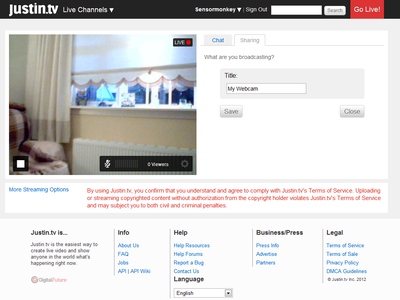

Step 5: Login to Justin.tv and Publish Audio/Video Stream From Webcam
Justin.tv is a free online service for broadcasting live audio/video streams. After creating an account, I can publish my live webcam feed by clicking the 'Go Live!' button in the top-right corner of the page. I allow access to my webcam when asked and click the 'Start' button to begin broadcasting. Once my channel is live, I can embed the output in a webpage using some simple HTML code (see the next step).
Important! If you have more than one webcam make sure to select the one that is mounted to the pan and tilt assembly. You can do this through the channel options when broadcasting your stream.

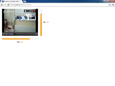

Step 6: Remotely Control Webcam Using JQuery UI
In the final part of this tutorial, I'm going to combine the live streams from SensorMonkey and Justin.tv to create a simple webpage that can be used to remotely control my webcam. I have downloaded the latest jQuery UI library (1.8.21 at the time of writing) and placed it in the same directory as the webpage (along with the associated CSS and image files for my chosen theme - UI lightness - see screenshot). You'll need to edit the code below and save it as 'Webcam.html':
(Important! You must replace YOUR_NAMESPACE and YOUR_PRIVATE_KEY in the code below with those assigned to you when you login to SensorMonkey. You'll also need to replace YOUR_CHANNEL with the name of your Justin.tv channel)

The code inside of the <object></object> tags is used to embed the live Justin.tv stream into the webpage. You'll need to replace each instance of YOUR_CHANNEL in the code between these tags with the name of your channel. The stream won't display on iOS devices (iPhone, iPad etc.) but will work on Android smartphones and tablets, as shown in the photos.
I use jQuery UI to create a horizontal pan slider and a vertical tilt slider to control the orientation of the webcam. When one of the sliders is moved to a new position, the code calculates a combined pan/tilt rotation, encodes it as a hexadecimal character pair (as described in Step 2 and Step 4) and sends it through SensorMonkey to the Arduino controlling the servo motors.
Finally, the workflow for connecting to SensorMonkey is very simple (don't forget to replace YOUR_NAMESPACE and YOUR_PRIVATE_KEY in the code above):
- Import client
- Connect to SensorMonkey
- Join namespace
- Subscribe to stream
Once subscribed, I can simply call client.deliverToStreamPublisher() to send data directly to the Arduino through the SensorMonkey service.
That's it! I can now remotely control my webcam in real-time using a combination of Arduino, SensorMonkey, jQuery and Justin.tv. I can upload the webpage to a public webserver and access it from anywhere on any device with a HTML5/Flash compatible web-browser. See the next step for suggestions on improving the implementation described so far.
