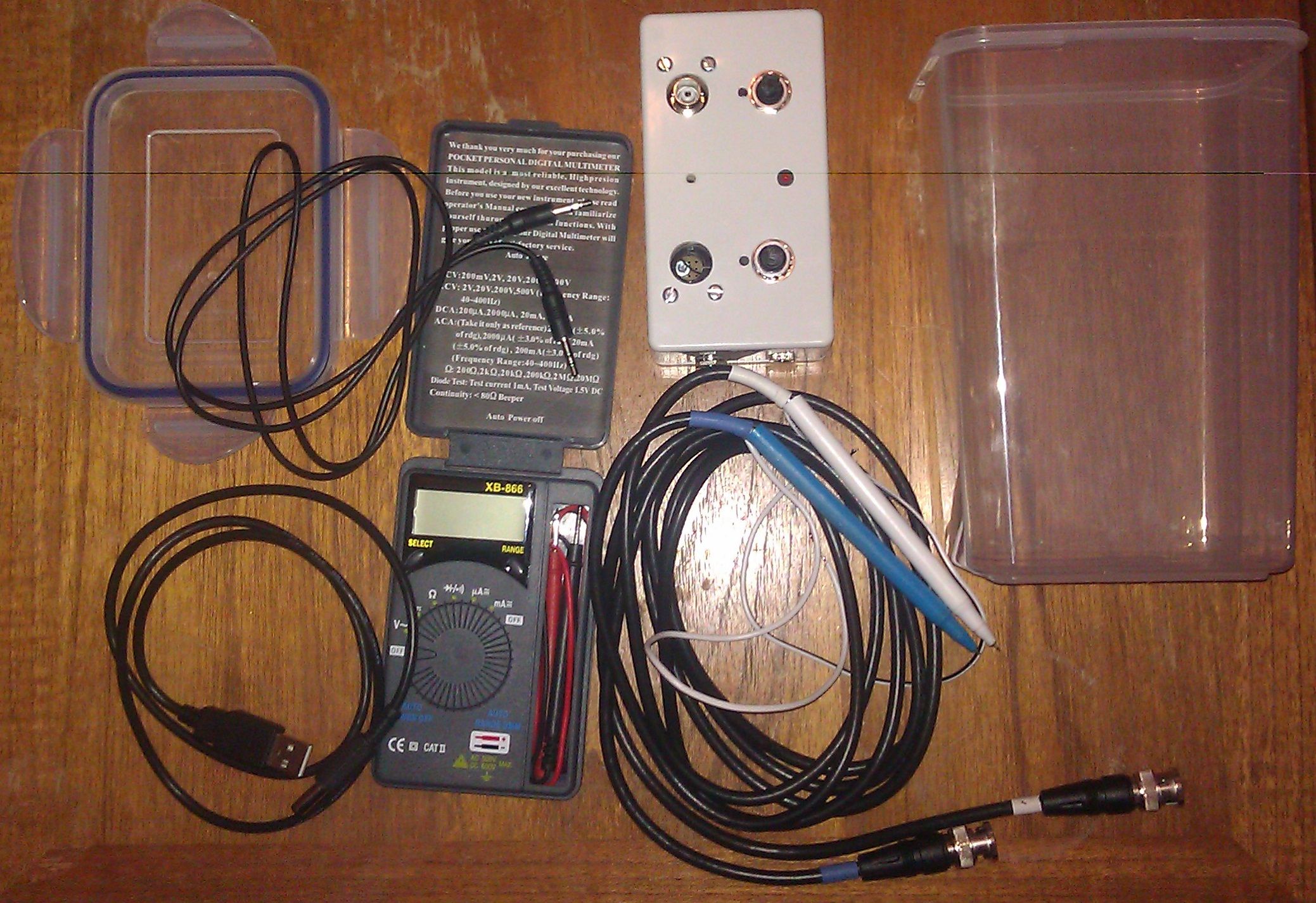

Step 3: Testing
connect the suply wires to power source 5v to 15v should do observe the correct polarity +ve to +ve etc. during testing check that components dont get hot.
The only component that may get hot is the transister under full load if neccersary fit suitable heat sink.
By swapping the min max pot ends changes the direction of rotation for off to full on.
Scope
probe the gate pin or base pin on the transister and rotate the pot from one extreme to the other and finaly centre, Check that the pwm signal is square wave and that the duty cycle changes apropriatly.
Frequency Meter & LED
probe the gate pin or base pin on the transister and rotate the pot from one extreme to the other and finaly centre the frequancy (aprox 10 Hz) should change but not significantly this is a function of the RC on the 555. True PWM the frequency is constant.
Take a suitable Load (LED and resister in series) and connect across the output turn the pot from extreme to extreme again LED should brighten and Dim accordingly.
Power Testing
To test under power a siutably rated load should be used as Im looking at using an approx 3ohm load (ie the heater cable) wire up and start test on low PWM checking the tempreture of the transister. Idealy the transister shouldnt go above ambient tempreture any power loss ie heat in the transister isnt power in the heater.
