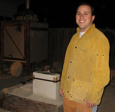

The final steps that need to be done before casting:
Carve vents into the mold to ensure that air can escape as the molten metal is being poured in
Coat the interior of the mold with a mold release such as powdered graphite or Duratherm
Close the two halves of the mold and glue together with Core paste
Strap the mold together with 3/4" steel strapping (like used on large packages) to ensure the mold halves hold together
Attach a pour cup to the sprue to ensure that there is an easy way to pour the molten metal into the mold
Step 10: Casting the Piece
This is the fun part! Now that the mold has been made, it is time to fill it full of molten metal. In this case, I was casting with Iron and worked with the Foundry at my local college.
You can inquire with local colleges that have metal casting programs or you can contact a professional foundry to have them cast your sculpture. Common metal choices would be Bronze, Aluminum or Iron - each has its own benefits and characteristics.
