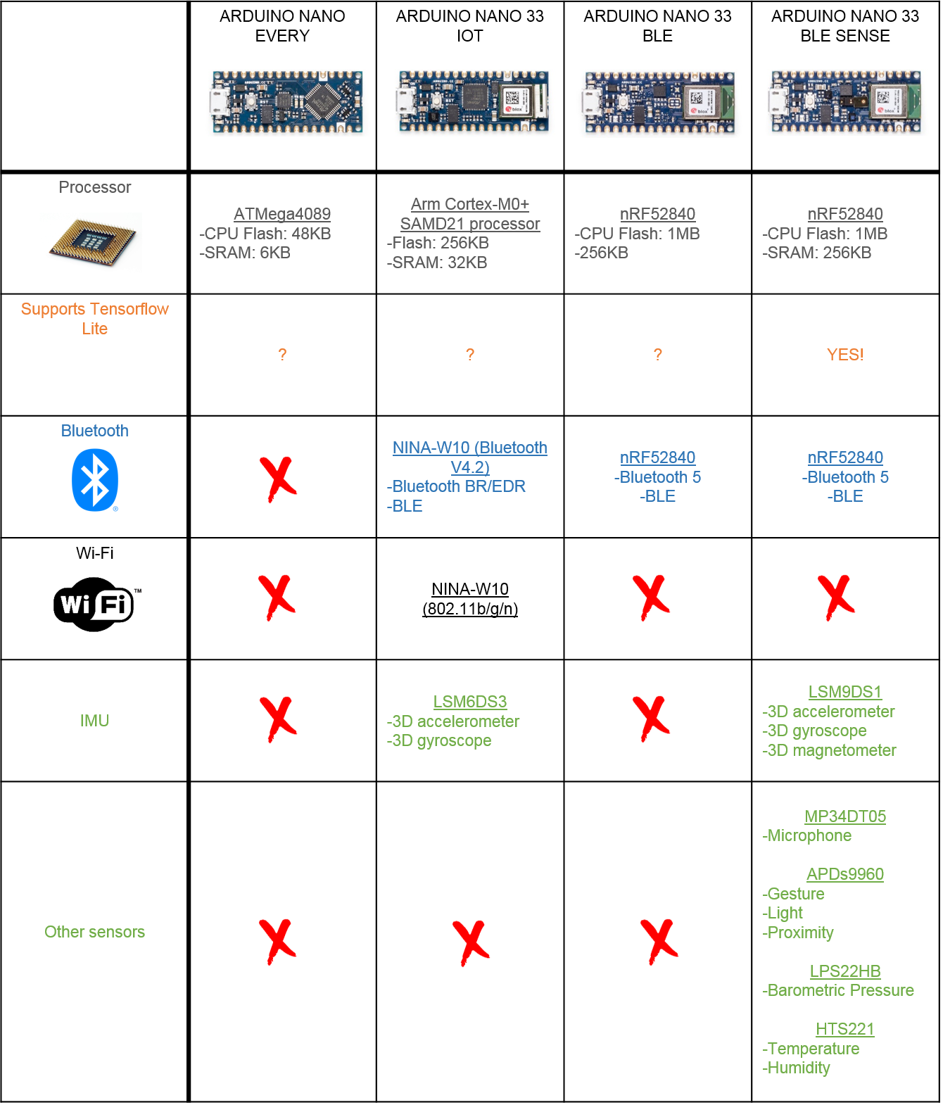

Step 1: Prerequisite (microcontroller, Codes)
After reading this post concerning Arduino boards and machine learning, I decided I had to give it a try. Since there are new Arduino Nano boards, I made a table to compare their characteristics, in order to make better choices before buying one.
All of these boards are really interesting, but the only one that could be used for gesture recognition is the Arduino Nano 33 BLE SENSE board since it is the only one to have sensors and supporting Tensorflow Lite. Another interesting point is that Arduino Nano 33 IOT, BLE, and BLE SENSE boards have Bluetooth, so all of them can be used on the LED matrix to receive the BLE signals.
As you will see later, the codes I uploaded on the Arduino boards are based on many Arduino codes I found. So before starting, I decided to test these codes with the examples I found.
