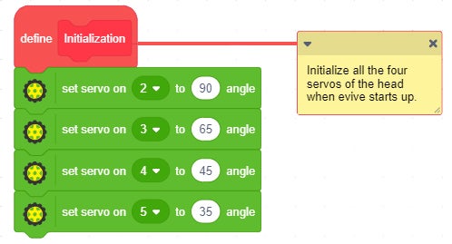

Finally, connect the face servos with evive
- Connect (HS-805BB Servo or Head Servo) Signal pin to pin number 2 of evive
- Connect (Metal Servo or Mouth Servo) Signal pin to pin number 3 of evive
- Connect (micro Servo or eye Horizontal Servo) Signal pin to pin number 4 of evive
- Connect (micro Servo or eye Vertical Servo) Signal pin to pin number 5 of evive
- Connect the VCC and GND of all the servo motor together and connect it to the VCC and GND of evive respectively.

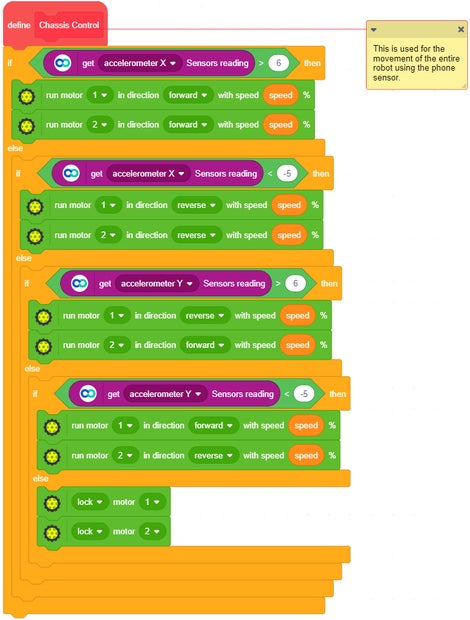

Connect the Humanoid Robot to Dabble via HC-05 Bluetooth module. You can control almost all the boards like Arduino Mega, Nano, Uno, ESP32, and evive using Dabble. Open Dabble and click on the Connect-Disconnect button. Choose your device’s name from the list.
We are using two modules together:
- Accelerometer (Phone Sensors)
- Input Module
Accelerometer
The accelerometer is used to control the DC Motors which is responsible for the movement of the robot.
Open Phone Sensors click on the toggling button next to the Accelerometer. This will start sending data to evive. When we tilt the phone either forward or backward, acceleration along the X-axis changes.
- If the acceleration along X-axis goes above 6 m/s2, then the robot will move in the forward direction.
- If it goes below -5 m/s2, then the robot moves in the backward direction.
- If we tilt the phone either left or right, acceleration along with the Y-axis changes.
- If the acceleration along Y-axis goes above 6 m/s2, then the robot moves in the left direction.
- If goes below -5 m/s2, then the robot will move in the right direction.
- If the acceleration along both the axes i.e X-axis and the Y-axis is between -6 m/s2 and 6 m/s2, then robot does not move.

Step 16: Code the Robot
We are going to use PictoBlox to code the Humanoid Robot. Upload the following script to evive:
