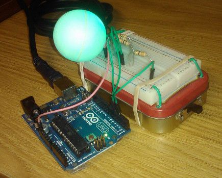

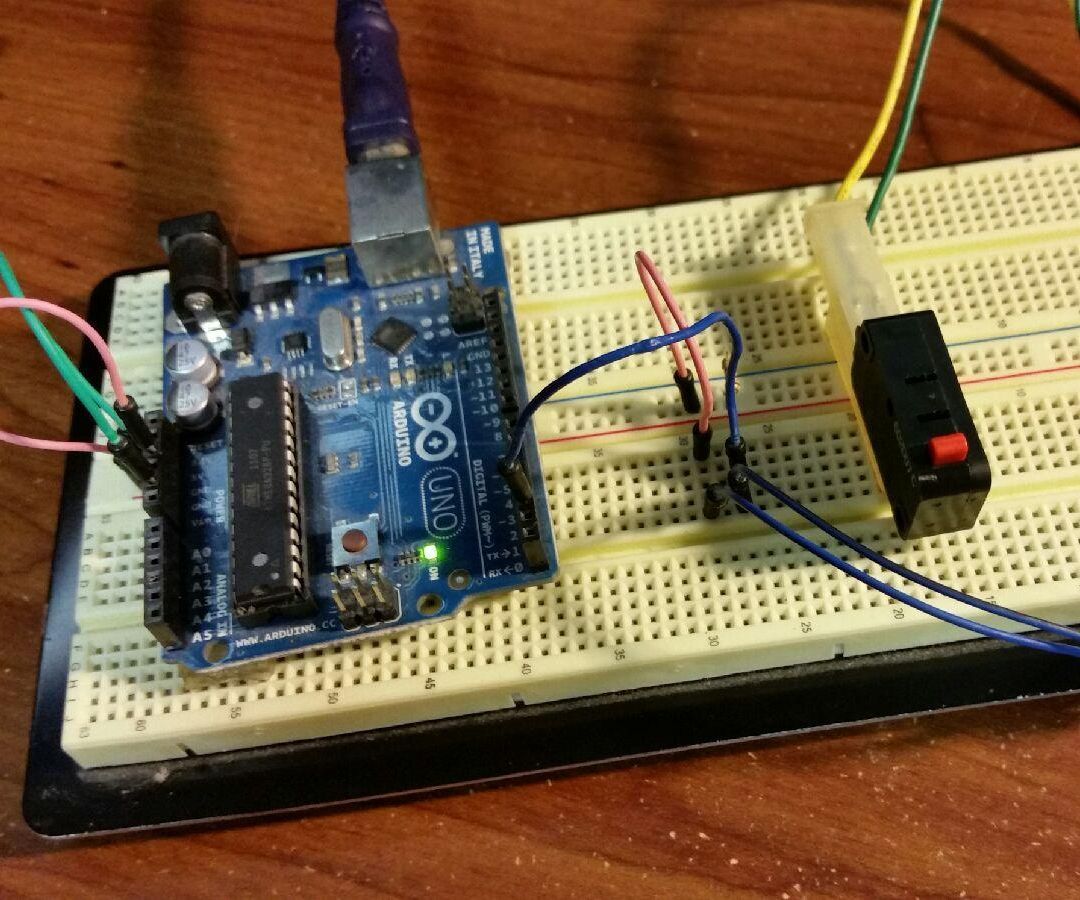

Step 4: Build the Circuit
Now it's time to build the circuit. Make sure to unplug your Arduino board before wiring it up.
Power and ground:
-Run a jumper wire from arduino "5V" pin to breadboard "+" rail.
-Run a jumper wire from arduino "GND" pin to breadboard "-" rail.
LEDs:
-Insert the LEDs into your breadboard as shown, with the longer leads farthest to the left. The red LED goes in the middle.
-Run wires from the each breadboard row with a short LED lead in it to the "-" breadboard rail.
-Run wires from the each breadboard row with a long LED lead to arduino pins 2 through 6.
Button:
-Run one of the buttons wires to the breadboard's "+" rail.
-Run the second wire from the button to an empty breadboard row.
-Run a wire from the same row on the breadboard to arduino pin 8.
-Run a resistor from that row to the breadboard's "-" rail.
Make sure your setup matches the pictures.
