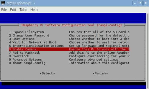

Step 3: Enable Camera
After the camera is physically connected you have to enable it. This is done using the native Raspberry Pi configuration tool - raspi-config. Run the tool using the command below.
sudo raspi-config

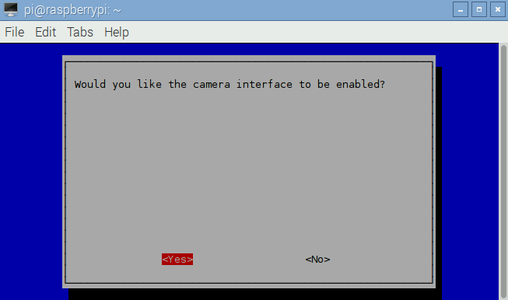

A menu with different configuration options will appear. Navigate to Enable camera and press enter.
Select Yes option and press enter.
From the main menu exit raspi-config by pressing the right arrow twice to navigate to the <Finish> option and press enter to exit. You will be prompted to reboot your Raspberry Pi for changes to take effect - select Yes.

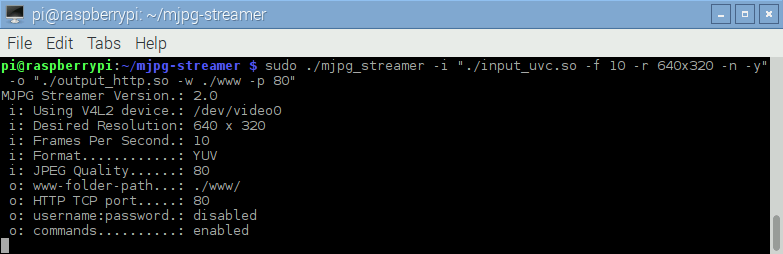

Step 9: Run MJPG-streamer Server
The command below will run the server.
sudo ./mjpg_streamer -i "./input_uvc.so -f 10 -r 640x320 -n -y" -o "./output_http.so -w ./www -p 80"
If you see an output similar to the one in the picture it means that the server is running correctly
