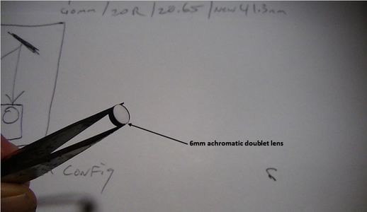

Step 8: The Lens Itself
This is the lens that you will carefully place in the beveled face of the holder, I used a "magic cloth," lint free, on a padded surface and placed the lens in the beveled groove and pressed it firmly in place.
Depending on how careful you were in preparing the face, it may drop in "too" nicely and you might have to appy a tiny fraction of acrylic glue to the inside edge and let the lens dry in place.
The most critical aspect of this step is perfect alignment! The lens to operate correctly, must be parallel to the farthest exit and closest opening, to avoid any reflective aberrations.

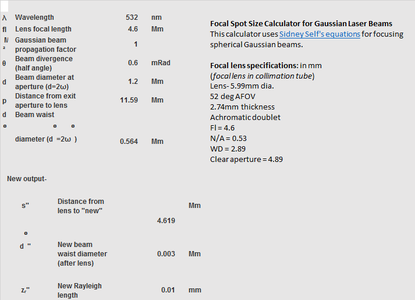

Step 11: These Are the Specifications for the Lens Itself and How the Focal Length Calculations Are Arrived
Step 12: Official Specifications of the Entire Collimation Tube Assembly

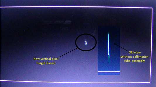

Step 13: Actual Collimation Tube Assembly in Action

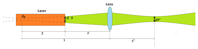

Step 14: Diagram Illustration for Focal Length Laser Calculations
