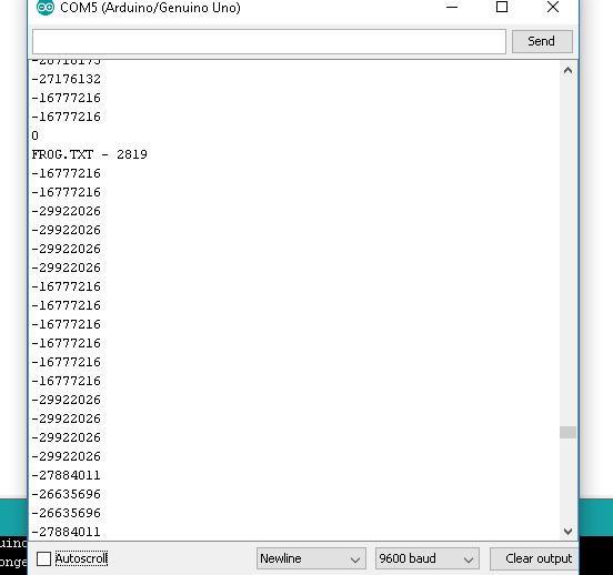

Step 6: The Code and Wiring
Overview
The code was developed using Processing and Arduino. To convert your own image or animation from a regular picture (or string of pictures), you need to first convert the image into a language that the Arduino can read from our SD card. After that, it is simply drag and drop to the SD card and the Arduino will do the rest!
Wiring the NeoBoard, SD Module, Arduino, and everything else together is fairly straightforward. Included in the pictures you will find a pinout for the Arduino to SD Module.
Materials and Preparation
- Arduino
- SD Card Reader Module
- Breadboard
- SD Card
- Wires
- Power Switch (Optional)
- Potentiometer (Optional)
Wiring the NeoBoard
- Using your Arduino, Breadboard, and SD Card Module, follow the pinout provided in the images.
- Connect your LEDs to the Arduino (5V, GND, PIN 6).
- The NeoBoard is ready to use.
- I added an external power input, capacitor, power switch, and potentiometer to my NeoBoard. This explains why I used two breadboards and had a plethora of wires.
Using Processing
The code for the NeoBoard is fairly simple. The Arduino reads text files from the SD card and displays them on through the LEDs.
- To convert your images (from .jpg, .bmp, etc) follow the instructions that are found in the Processing code.
- After you have converted your images into .txt files, you will need to load them onto your SD card.
- Once the SD card is loaded with the .txt files and the Arduino is loaded with its code.
- Plug and play.
