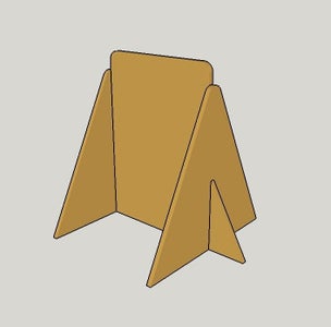

Nicolas, in the description of his video also added a link to a 3D printable file and to a simple template, but since I wanted to have 3 detachable pieces, I created my own version (photo#1).
Step 3: The Pieces
Print the template (or draw it), cut the 2 pieces, and mark a line all around the edges (one time for the bigger one, and two times for the triangle piece).
In order to cut the 3 pieces as neat as you can, I suggest you to use a x-acto knife and a metal ruler to score the material following all the lines.
Once you get the 3 pieces, use the sanding paper to smooth all the edges.
The material that I used is 3mm thick, but in order to make the pieces to fit together without glue, I cut the "dados" a little smaller (about 2.9mm).

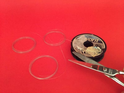

Step 4: The Fishing Wire
Cut 3 pieces of fishing wire long 2m each.
NOTE: Be sure to use a strong fishing wire, or your iPhone will fly for real!!
Then drill 2 holes per anchor point (2nd picture), insert the wire through them, and tie a couple of knots on each wire to secure it well to the bigger piece of the centriphone.

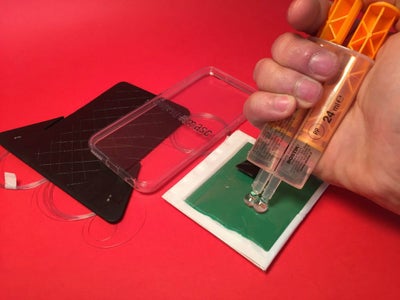

Step 5: The Silicone IPhone Case
Now it's the time to attach the iPhone case.
Be sure to use a silicone case since it's flexible (not like the the plastic ones).
In order to make the joint as strong as I could, I used the x-acto knife to make little scores both on the back of the case and on the bigger piece of the centriphone (2nd & 3rd picture) before glueing the pieces with bicomponent epoxy.
NOTE: Check that the glue that you want to use is compatible with the materials that you are working with!

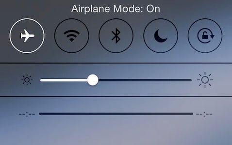

OH! AND DON'T FORGET TO TURN ON THE AIRPLANE MODE!! :P Ahaha
