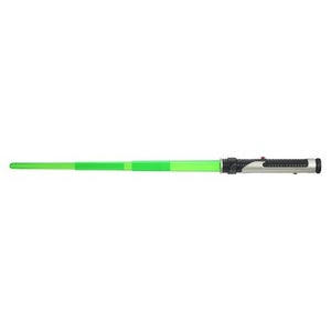

Step 1: First Version
I started by building a cheap version. PVC pipe + pipe insulation foam + duct tape = a better dueling light saber. We played with these sabers for months. We even broke a few, and inflicted serious injuries upon each other. PVC is heavy. It brings the total force of a solid blow down to about 10 newtons which is far better but not good enough. They were far better than the cheapy toy sabers though. They were strong, repairable, and worked. After a good deal of time we began getting tired of always getting injured every time we dueled. I started to think about crafting the ultimate light saber for dueling. Something strong, light, fast, and comfortable to wield.
Step 2: Making the Mold
I had never made a mold when I started this project. I tried and failed 4 times before ending up with a usable mold and spent over $250 in the process of failing. I finally found success using plasti 73-10 silicone. I took the toy light saber, primed it, sanded off what I did not want and sprayed it with mold release. I used foam board to create a nice box, and poured the mold. After it was dried I cut one side of the silicone mold in a zig-zag pattern and pulled the saber out.
Step 3: The Rig
I spent $80 on silicone alone and found it was not enough after I poured it. I had to squeeze the box to get it to fill up. This made some areas of the saber have less than 1/2" of silicone around it. To strengthen the mold I built a makeshift rig which supported the silicone and kept it straight (I used a random box, filled with sheet rock joint compound). The rig also serves to hold the carbon fiber rods (blade) straight while the resin/epoxy dries.
I got the rod on ebay for about $30 with shipping each. 18MM ID. X 20MM OD. X 1000MM Length.
Step 4:
I painted them and rubbed on a wax/silver powder mix and sanded with steel wool and buffed it with a buffing pad on my grinder. I sprayed on some clear coat. I put smaller diameter, higher density foam pipe insulators on the carbon fiber rods. I wrapped the foam in colored duct tape. I brushed on glow in the dark paint.
I spent roughly 20 hours trying different mold making techniques, and failing miserably before I got it right. Now I can make a light saber in a bout an hour start to finish.
