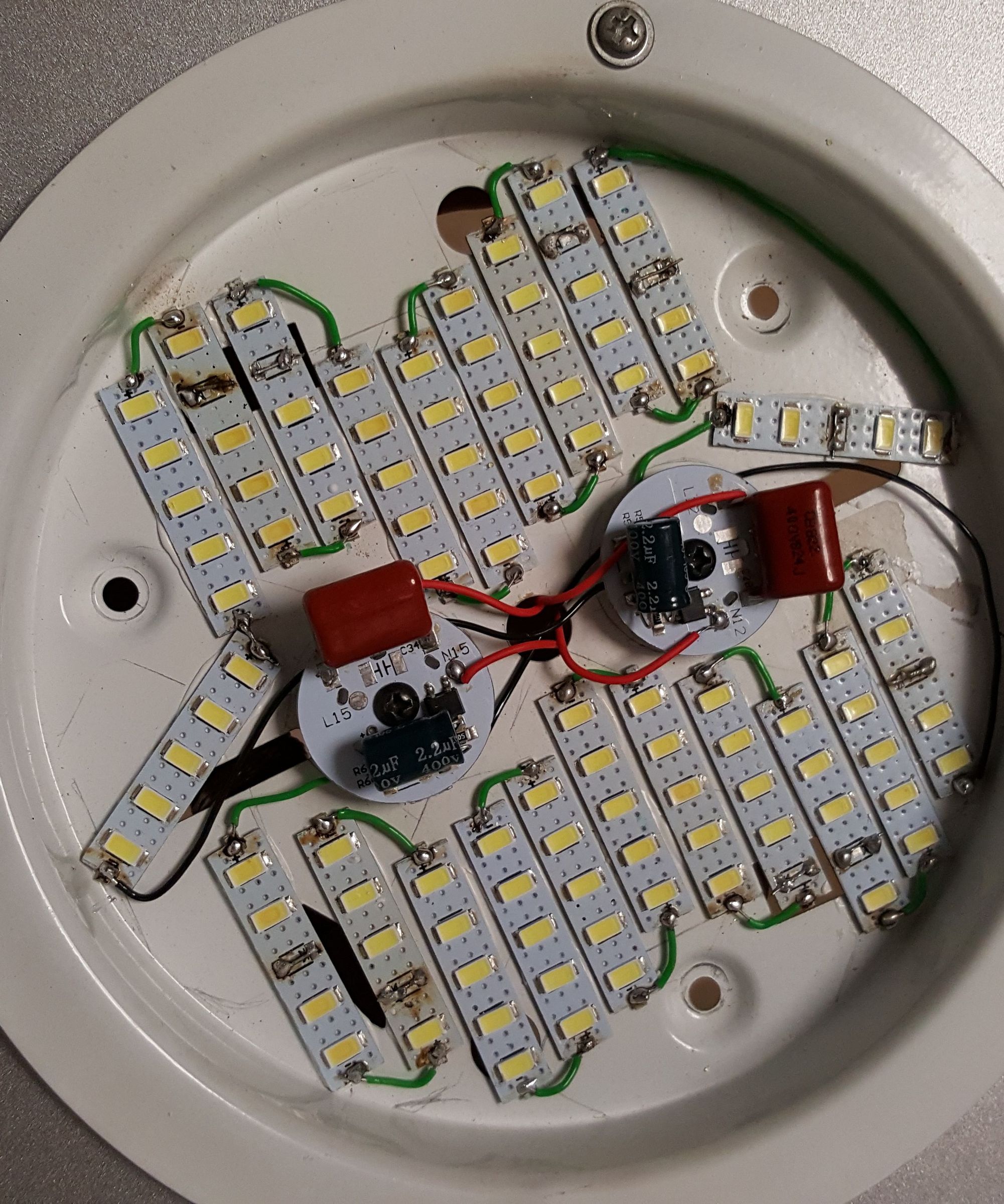

Step 2: Getting the LED Strips From the Bulb
By popping the top of the bulb I then un-soldered the four LED stips I needed
Step 3: Wiring
I then stuck the strips to a plastic card cutout and wired them in parallel so they each received the 14.4v.
I used the wires to attach this to the USB lamp.
