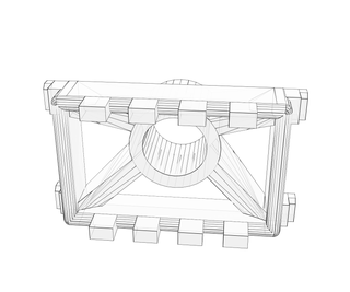

Step 1: 3D Print the Custom Carriage
I made my object using OpenSCAD.
It is composed of 2 files:
- the carriage itself
- the blade holder support that combines with it.
To make your life easier, I provided the STL file, ready to be printed.
No much thing to say about 3D print itself, I used 0.2mm Z resolution + support.
This carriage will position the blade holder tip a bit above the limit of the Z axis, so that it is not possible for the native platform of the Fabtotum to hit the blade directly.
Anyway, you will need to add a (wooden) plank (say 10-20mm), a cutting mat, and your vinyl sheet on the top of the platform. That will be more than enough to get the blade in touch with the vinyl.
