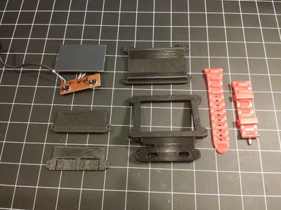

Materials list:
- 1x set of 3D-printed parts (next step)
- 1x Adafruit Capacitive Trackpad
- 1x iKen Watch Buckle Strap
- 1x iKen Watch Sizing Strap
- 2x 1" 2-56 machine screws

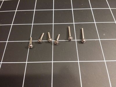

- 4x 3/4" 2-56 machine screws
- 12x 2-56 hex nuts

Download the attached STL files, slice 'em up, and print 'em out. If you don't have a printer, contact me and I'll sell you a set of parts.
I recommend 0.2mm layer height, 8% infill, support material, rafted. The raft will ruin the texture, so if you have a heated chamber/bed, use it instead to prevent curling and warping. Increase the infill to 15% if you want a weightier, more substantial gesture pad. Be sure to lay the components flat against the build plate before slicing to save on support material.
This model will print fine with ABS or PLA. I printed with PLA, but ABS is probably smarter because it's more stable when wet and sticks harder to a heated bed.
I also attached the SketchUp file for your hacking pleasure..

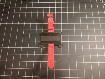

Slide the bands into the slots on the baseplate. The sizing band (the one without the buckle) goes into the slot on the notch side of the baseplate.

Insert the 3/4" screws into the four holes on top.
Flip it over and add the baseplate. The notch fits around the button enclosure. The baseplate should sit flush - if it doesn't, adjust the ribbon cable, PS/2 cable, or PCB's, or trim off any remaining bits of support material. Don't force it - I designed the model with generous tolerances, and it will fit flush.
Add nuts to the screws and tighten.

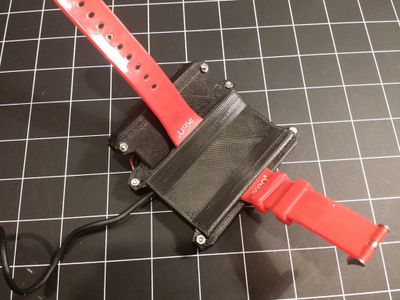

Add the button retainer plate. You will need to lift up the sizing strap, push the plate in at kind of a weird angle, and swivel it into place.
Flip the model over, add the buttons plate, and push the 1" screws through. Test that the buttons click smoothly. If they don't, take off the buttons plate and add a dab of hot glue to the bottom of each button. The buttons should sit flush against the microswitches and have a hair trigger.
Flip the model over, add nuts, and tighten the screws. Your wearable gesture pad is now complete.
