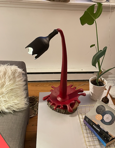

Introduction: Wine-Splash Lamp
The project constitutes the design and assembly of a desk lamp featuring the visual appearance of wine dropping from a broken bottle.

The overall design is broken down into a total of 11 components. Only components As resulted in a modified version of an already published design. All other components were custom designed using Fusion 360. The first 4 parts being A1-A2-A3-A4 are the bottom parts making a visual representation of a wine splash. Components B-C-D-E form the frame of the lamp in the form of wine dripping from the bottle. Components F-G-H form the lamp in the form of a broken wine bottle with a bulb socket inside to screw a light bulb. A visual representation of the overall assembly of each component can be found above. Further specification regarding the dimensions of each part is provided below.

Step 5: Result & Improvements
Potential Improvements
After several design iterations, here's below a list of potential improvements to consider if one wishes to reproduce and improve the results:
- Different post-curing techniques could be experimented with to induce a glossy finish to the 3D printed components. *
- Instead of relying on glue for the assembly of each component which minimizes portability, threading can be implemented allowing each component to screw into one another. Doing so could allow easy de-assembly to either modify or relocate the lamp.
- Instead of relying on an acrylic sheet to mount components A, the design can be modified by adding screw thread allowing to screw each component firmly onto the wooden component.
- The utilization of a real broken wine bottle could be explored instead of using a 3D printed model. The difficulty comes from breaking the bottle at the desired location with the desired patterns. Glass often breaks following unpredictable patterns.
- The wooden structure could easily be further modelled allowing it to house further electronic circuits providing features such as a USB connection acting as a phone charger.
Overall, the project was a success and the lamp was given as a gift. Feel free to improve the design by adding additional features. Ensure to share your improvements with the community!
