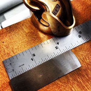

Step 1: Deciding on the Size to Make
There are many different sizes of thumb plane, the smaller they are the tighter the interior curve they are capable of planing. The Ibex plane here has an 11/16" wide blade, and I love it's performance, so I will attempt to emulate its size in my design. The radius of the grind at the bevel is 1 1/2".

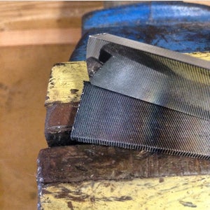

Step 2: Making the Blade
A standard mill bastard file provides the perfect size steel for a blade of this type so I measure how much I need, then heat up the steel red hot using MAP gas in a standard plumbing torch. Let the steel cool slowly, and at this point it has been softened sufficiently to be able to cut through with a standard hack saw.
Grind and sand your blade blank down to 11/16" wide by 2 3/8" long. I flatten the surfaces on a belt sander first, then a grinder and finally on stones. The radius on the business end of the blade is 1 1/2", or roughly the same as the inside of a role of duct tape.
Grind the radius onto the end at 90 degrees first, then hollow grind up to it at approximately 30 degrees. Leave a small square section at the edge so that it won't crumble when it's heated and quenched afterward.
Polish the back of the blade flat on your sharpening stones now, while the steel is soft. I like to leave just a shadow of the pattern of the file on the blade, I think it looks cool, and shows its handmade.
Re-harden the steel by heating it back up to cherry red, then quenching it quickly into peanut oil or water. At this point the steel is now too hard and brittle, so soften it just a little by putting it in the oven at 200 degrees for 1 hour.
Apart from cleaning it up and sharpening it, you now have a finished blade, so don't burn it, and grind slowly. Of course you could skip all this and just buy a replacement Ibex blade, but that's no fun. For a little extra information on sharpening I've embedded a YouTube video about sharpening from my channel.

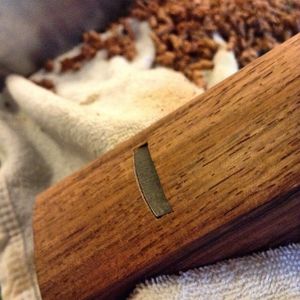

Step 8: Shaping the Sole
File or chisel away the leading edge of the mouth of the plane until the blade barely exits the bottom. I remove this material at the same angle as the blade (45 degrees) so that I can trace the curve of the blade onto the wood as a guide. Remove the majority of the wood with a block plane, then with a piece of 220 sandpaper laid out on a flat surface, finish refining the curve by planing the sole on the sandpaper. When the two match perfectly, you're done.
Step 9: Setting Up
At this point the mouth should be opened up at least 1/32" and shaped to allow shavings to not get jammed into the body. The wedge should be carved to your liking but should let you adjust the blade with your fingers. The tip should also be cut back and shaped to allow shavings through unobstructed. Your little plane in now a coopering plane and will take great shavings in a straight line, but still needs more work to become a luthier's plane.
