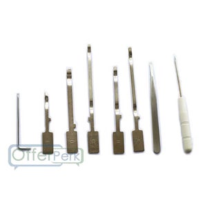

Tools:
Kit:http://www.ebay.com/itm/like/111230453099?lpid=82
> http://www.ebay.com/itm/US-Best-Unlock-Opening-Dis...

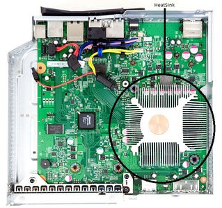

Now again if you have experience you obviously know that the fan is what were going to be taking off. Now be careful. Once its off , if any thermal paste is left REMOVE IT, you can do this with a credit card or something that wont scratch the surface. This is just like putting on a heat sink for a computer(if you have done it).

Put it on: Now putting it on, take your thermal paste and put a dot on the heatsink (copper part as seen in the picture). Make sure you spread it well or you will experience heating errors, same for too much thermal paste. You can spread it with a credit card but nothing that can scratch it! Once on make sure you secure it, dont make holes where ever just so its secure , check for wiring or anything and use the screws that came with it and make sure it doesnt fry the motherboard! One done you basicly good , you can put the fans where ever and put water in(CHECK FOR LEAKS BEFORE!) .
