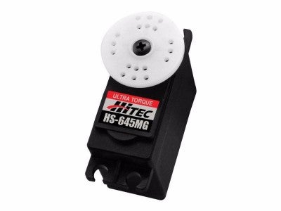

Hitec HS-645MG Servo
Quantity: 12

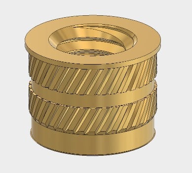

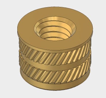

Step 3: Install Heat-Set Inserts Into Covers
In order to partially conceal the quadruped's leg mechanisms and improve the aesthetics of the robot, the femurs and coxas have decorative covers. The covers are simple 3D printed plates that mount onto the leg sections. The covers will mount to the corresponding leg assemblies using M3 machine screws. Rather than trying to force the screws to thread into the 3D printed covers, or try to design the covers with a captive nut, we will create metal threads for the covers using heat-set inserts.
Heat-set inserts are simple parts, but they will allow the cover pieces to be attached and detached with ease. To install the heat-set inserts, we will need a soldering iron, a pair of hemostats, and a way to hold the 3D printed covers steady. For this last piece of equipment, I am using a great helping hands tool from QuadHands.
To install the heat set inserts, warm your soldering iron to 230o C. Then, with the 3D printed part clamped in place, hold the heat-set insert with the hemostats just over the hole. Press the heat-set insert into the plastic part with the soldering iron. The heat from the soldering iron should melt the plastic, allowing the heat-set insert to set into the part. Try to work quickly to avoid applying too much heat and deforming the plastic surrounding the holes.
Install heat set inserts into both hols on each of the 16 cover pieces.

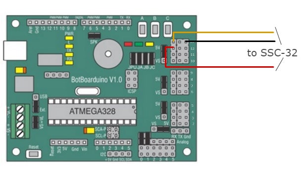

Step 23: Connect Wires for SSC-32 Connection
Because we will be placing all of the electronics into a kind of stack inside the robot, there are some wires we need to add now that will connect to other components later on; this will prevent the pins we need to connect from being obstructed by other parts. The first set of wires will eventually connect the Botboarduino to the SSC-32.
The Botboarduino communicates with the SSC-32 over a serial connection; so there are two wires that form the serial connection, plus a ground connection. Place a wire on the ground pin closest to the standoff closest to the set of four jumpers. Then, for the actual serial communication, place a yellow wire on GPIO pin 13 and a red wire on GPIO pin 12.

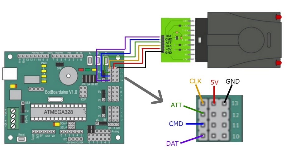

Step 24: Mount and Connect PS2 Controller Receiver
The robot is controlled by a third-party Playstation 2 wireless controller from Lynxmotion. The receiver for the controller will be mounted above the Botboarduino on one of the nylon standoffs already in place. Before attaching the controller receiver to the bundle of electronics inside the robot, we need to connect the controller to the Botboarduino.
There are a total of six pins on the controller receiver.
PS2 Controller PinBotboarduino Pin
DATconnects toGPIO 6
CMDconnects toGPIO 7
ATTconnects to8
CLKconnects to9
GNDconnects toGND
5Vconnects to5V

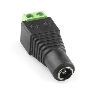

Step 25: Add Power Wires
A single power supply delivers energy to both the Botboarduino and the SSC-32 servo controller. The power supply connects directly to the SSC-32, a setup we will wire in the next step, and then the SSC-32 and Botboarduino power systems are tied together. In this step, we will add a pair of wires to the Botboarduino that will later connect to the SSC-32.
On the Botboarduino, there are two power input screw terminals: one labeled VS and one labeled VL. Connect a black wire to the VL negative screw terminal and a red wire to the VL positive screw terminal. For now the wires will just be left dangling.
Step 26: Connect Power to SSC-32
Now there is a wire attached to the Botboarduino waiting to deliver power to that board from the SSC-32. The SSC-32 will have two power wires connected to it. First, connect a black wire to the negative terminal of the barrel jack adapter and a red wire to the positive terminal.
On the SSC-32, there are three power input screw terminals: VS1, VL, and VS2. There are also three pin jumpers, two on the VS2 side and one on the VS1 side. It should be set up this way out of the box, but make sure all three pin jumpers are connected. This setup basically ties the servo power system and the logic power system together so that both systems can be powered by a single power supply.
Connect the wires from the barrel jack adapter to the VS1 screw terminal using the same polarity as we did on the adapter.
Now connect the wires from the Botboarduino in the previous step to the VS2 screw terminal, matching the polarity. Now the power system goes like this: the power supply delivers power to the left side of the servo power system on the SSC-32, one of the jumpers links the left and right sides of the SSC-32 so both receive power, the second jumper delivers power to the logic circuits on the SSC-32, and finally, the right side of the servo power system on the SSC-32 passes power to the Botboarduino.

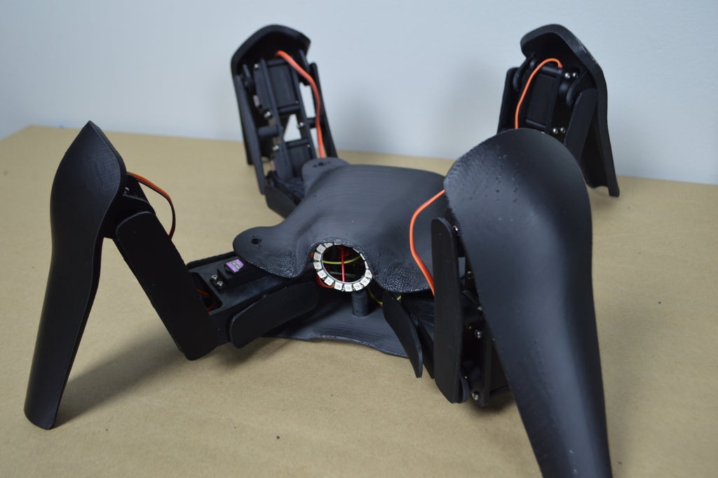

Step 31: Control Your Quadruped
Congratulations! Your 3D printed quadruped robot is now complete. The only thing left to do is turn it on and take it for a walk.
To turn on the robot, simply plug it in to the power supply. Be a bit careful when you do this because it is likely the legs will jerk suddenly as they are first delivered power and the Botboarduino initializes.
The Botboarduino can be armed or disarmed for motion using the PS2 controller. To arm the robot and enable it to accept your commends, press the start button on the PS2 controller. The Botboarduino will confirm it is armed with a single beep.
After that, review the diagram below for the quadruped's control setup.
Have fun with your new robot! Your new quadruped can even thank you with a bow.
