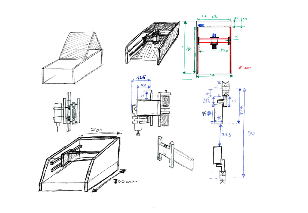

With that in mind, I started to draw some sketches and after a few days I came up with the main idea. The CNC would be closed on the side with the possibility to add a futur plexiglas Hood on the top. All the electronic would be on the back.

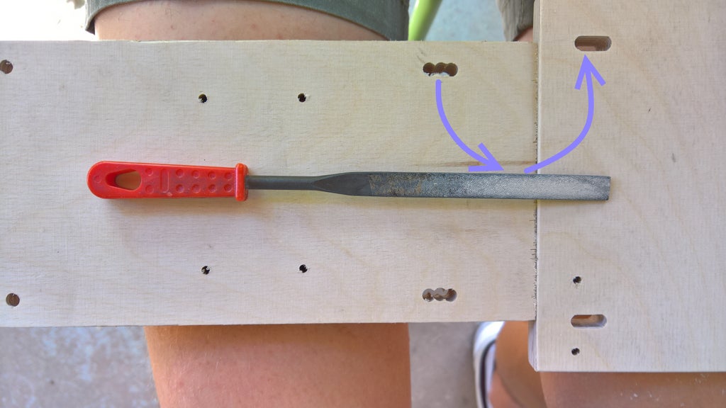

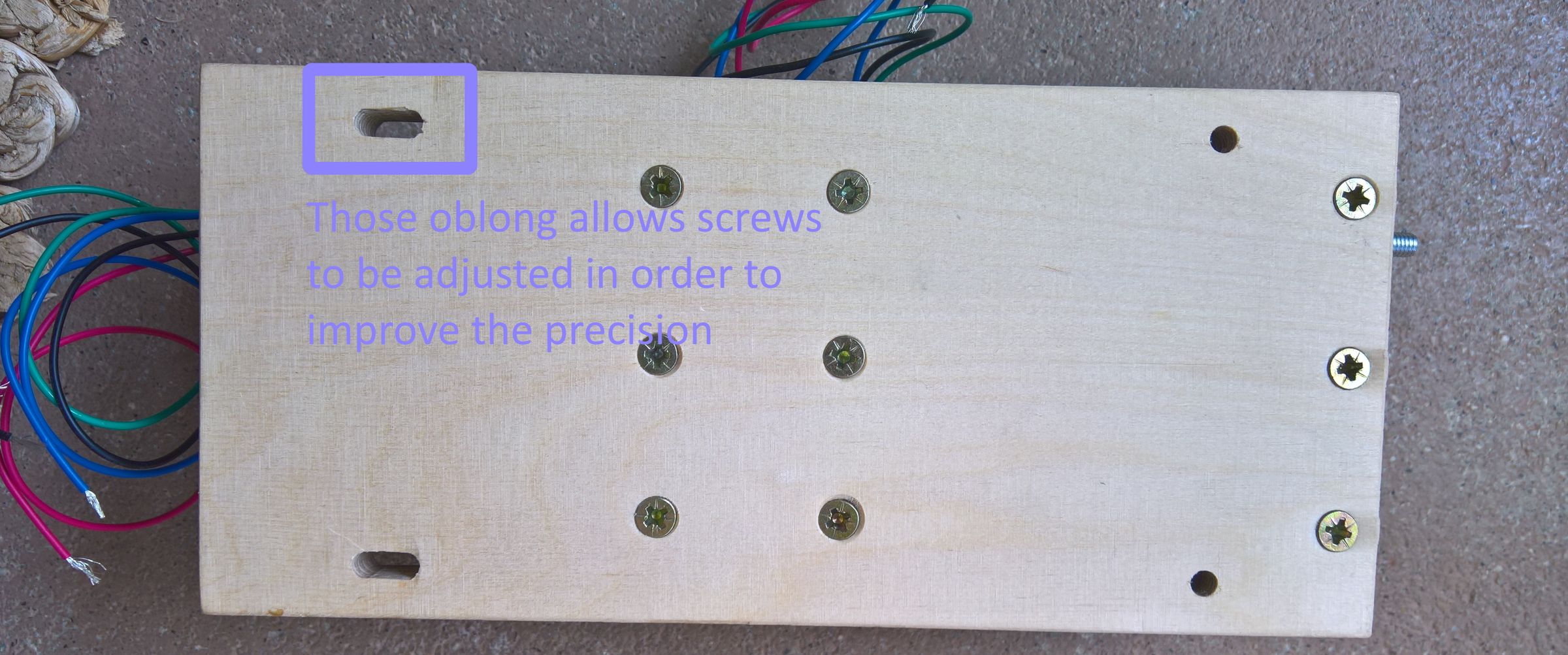

As almost every plank is square, I went to the DIY store and asked for wooden plank with the correct dimensions for the small ones. The bigger ones I did myself with a jigsaw but order it directly to the DIY store gives better results.
I recommend you to be specially precise with the wooden stick for the X axis and the drill holes. As you will see, some plank have oblong (long holes). Their purpose is to adjust bearings' positions during the assembly. I made them by drilling multiple holes and then by using a file as you can see here :

Note : the schematics with colors of the inside of the case indicates the height of the rails.

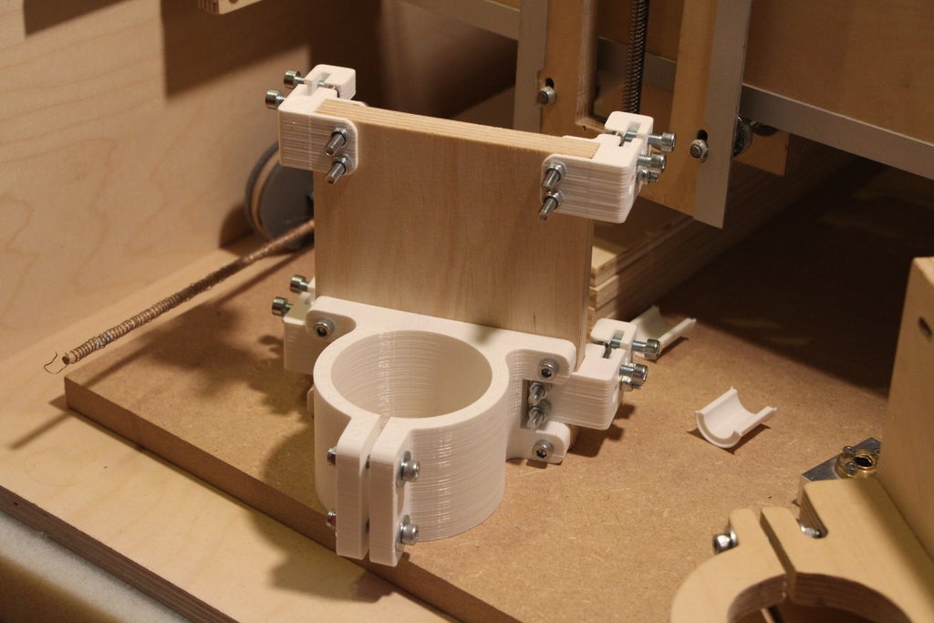

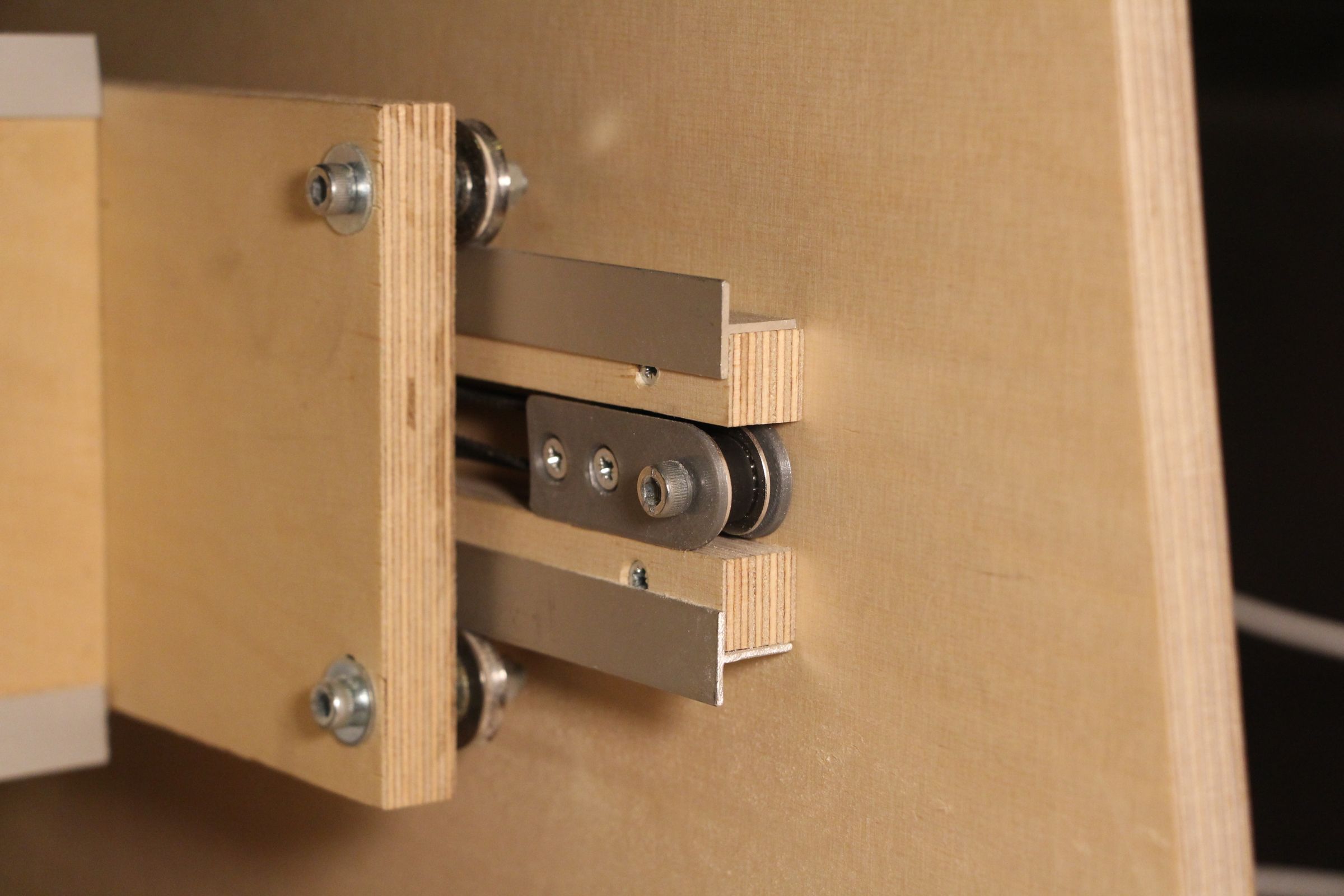

The bigger bearing near the motor will be used for the timing belt along the X Axis. When you screw the Axis_Z_TProfilAlu on the Axis_Z_Rail, make sure that the screw does not protude from the surface otherwise the bearing will touch them.

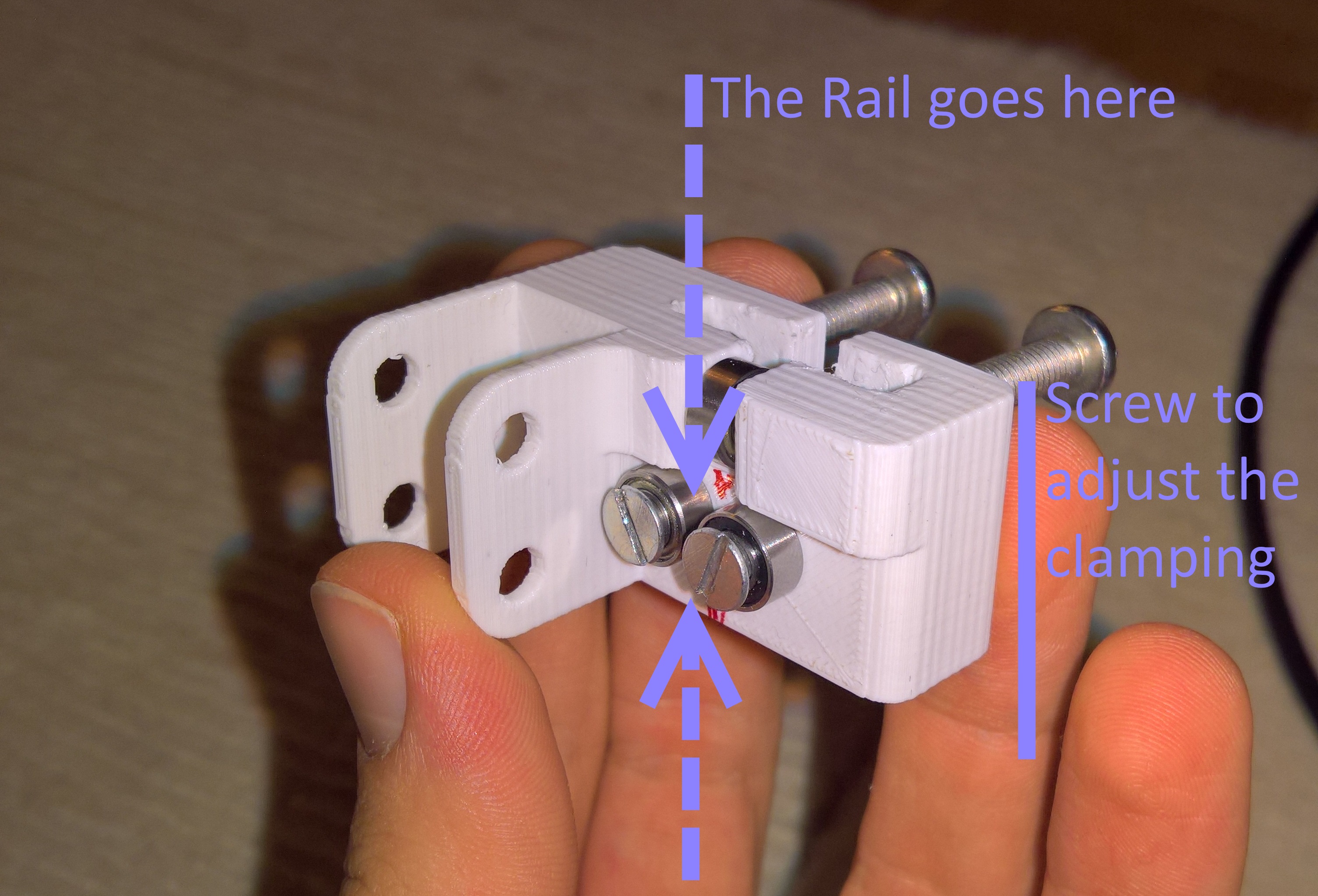

Mount the router support : Use the 3D printed parts :
With the Router holder they go like this : (drill the holes with 3d printed parts in place if possible)
STL files bellow

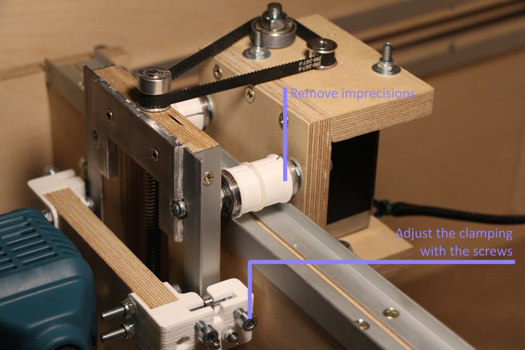

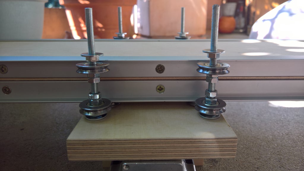

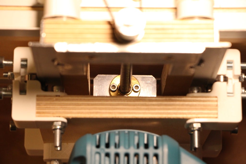

First of all, mount the X axis on the Z axis. Assemble both with M5 nut and threaded rod of 90mm long.
Between the two bearing must be placed two 3D printed parts to remove imprecisions. They hold together with a zip tie. You will find several version of it in the .zip bellow because the distance between the two bearing varies from 26mm to 27mm.
Add the Z axis threaded rod with the pulley (that can be 3D printed). The closed timing belt is stretched with a bearing. You may have to add a custom 3D printed ring to keep it in place.
Custom 3D printed pulley on thingiverse
To mount the part that hold the router (Makita RT0700C actually), use the 3D printed part (which is in aluminium here). Place it in the threaded rod and screw it with M5 hex head.

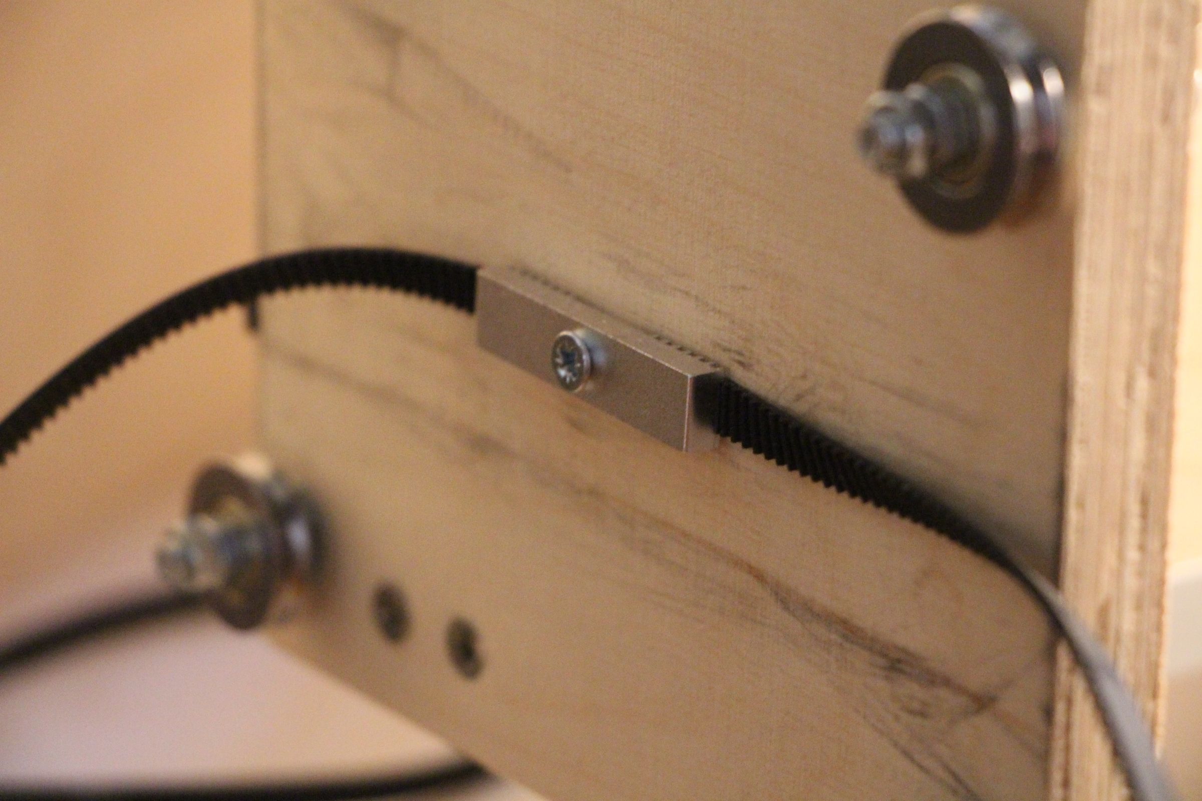

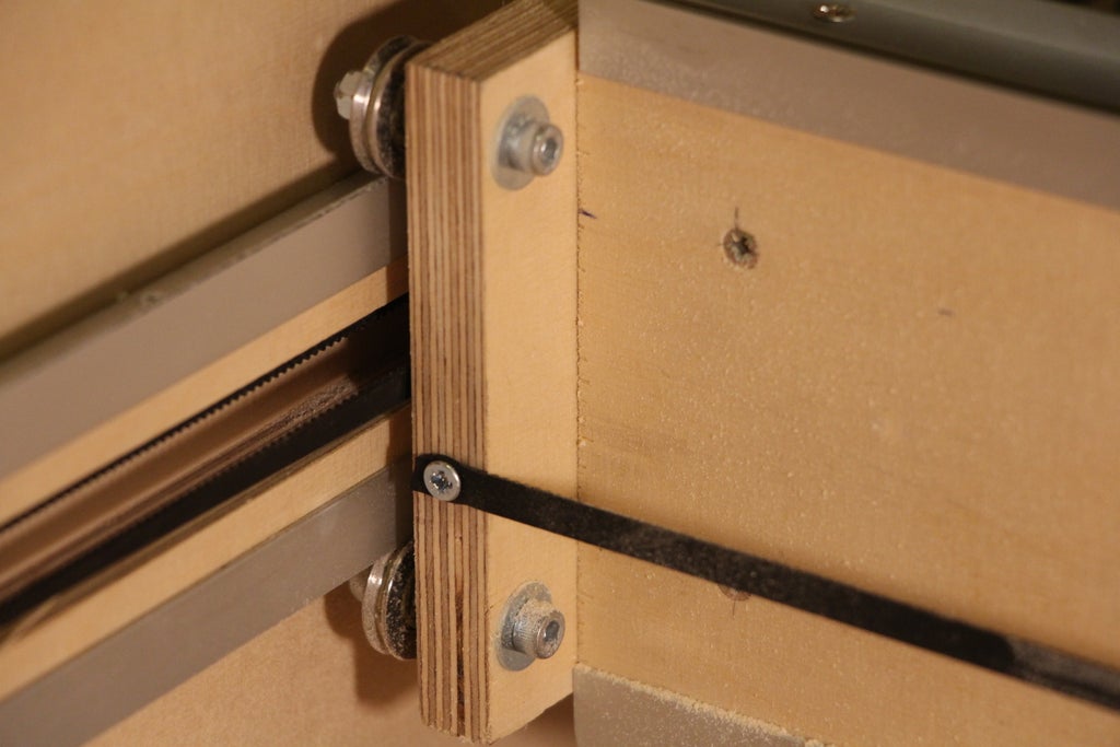

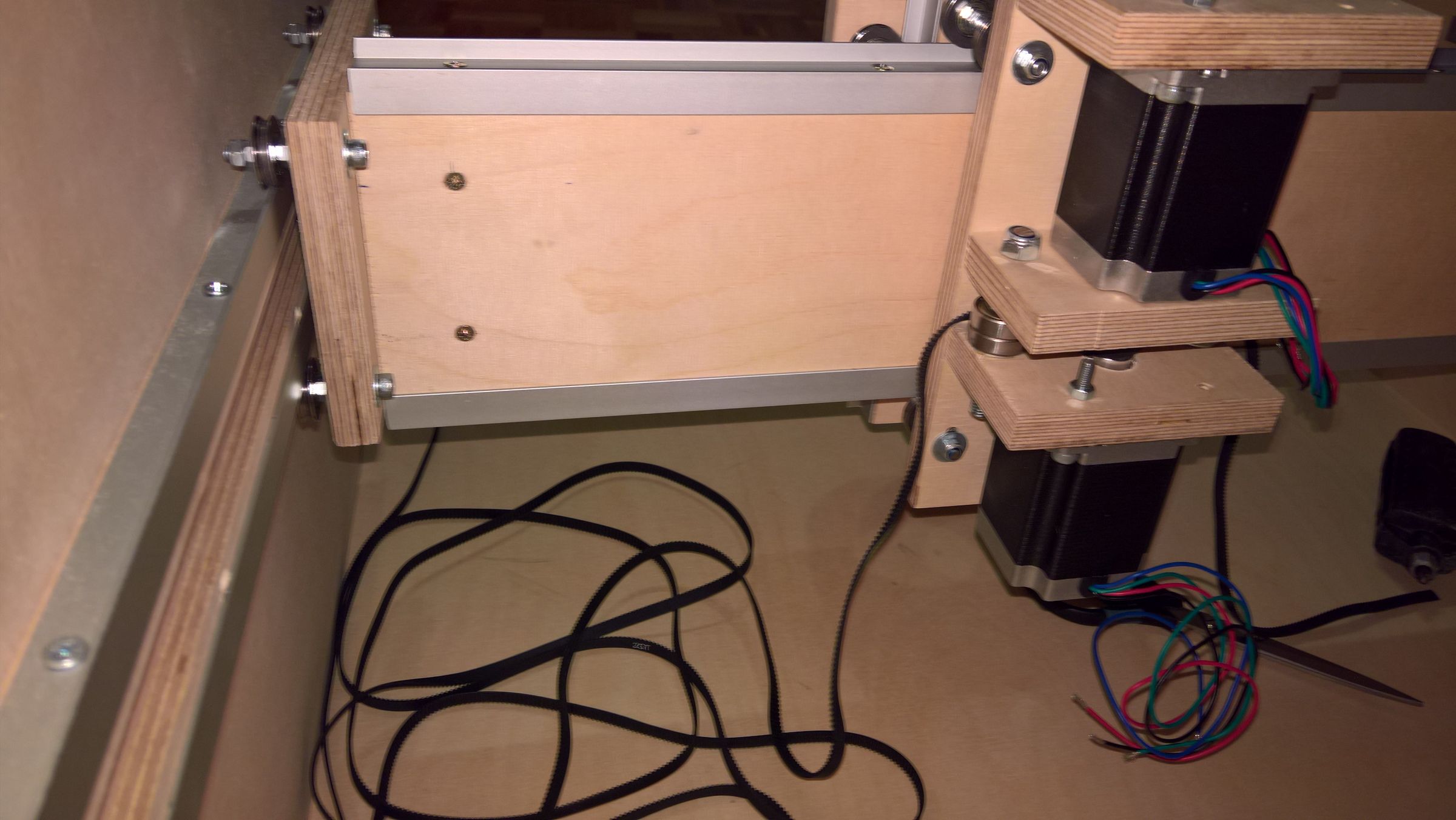

On the back of the X axis, I fixed the timing belt with a wood screw. This is probably not the best idea but it works. Maybe it would be great to add a washer. This timing belt go through the Z axis on the bearing and the motorised pulley.
Y Axis
The Y axis move the X axis from back to front. That's why we will put a timing belt between the two rail (as shown above).
First attach the belt of around 140cm (mesure it!) like that : (and one on each side)

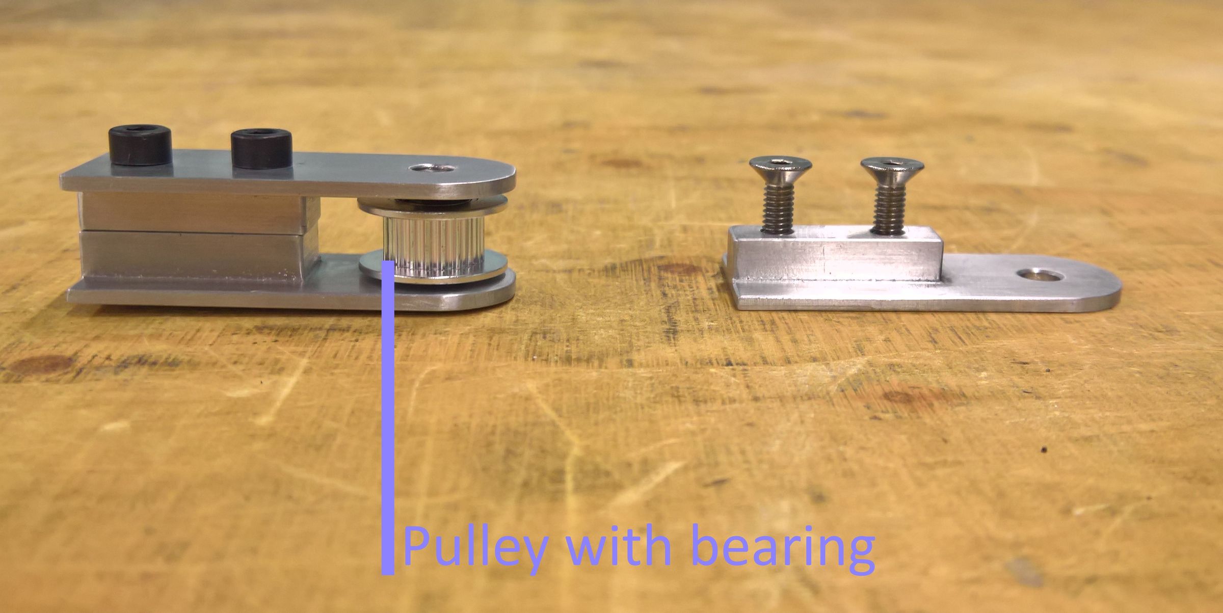

On the front end, the belt rotate arount a free pulley as shown bellow.
Note I use both aluminium and 3D printed version, one on each side.
Mounted with two wood screw and a M5 screw for pulley, it looks like this :

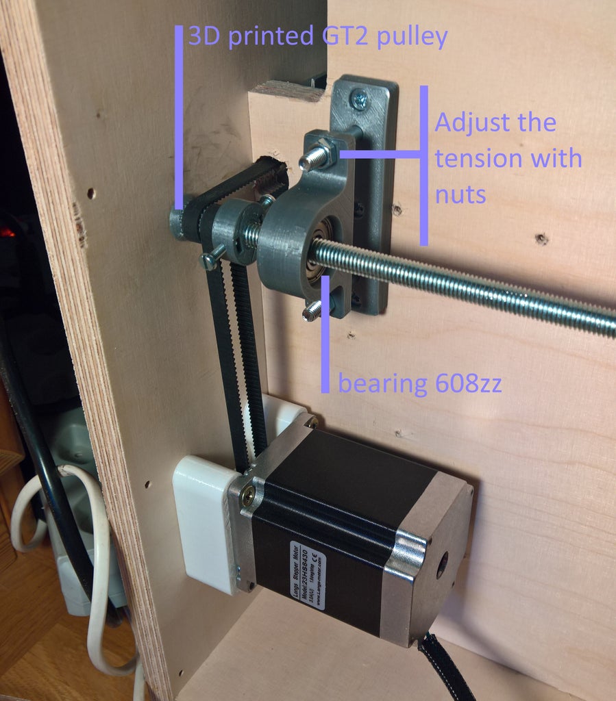

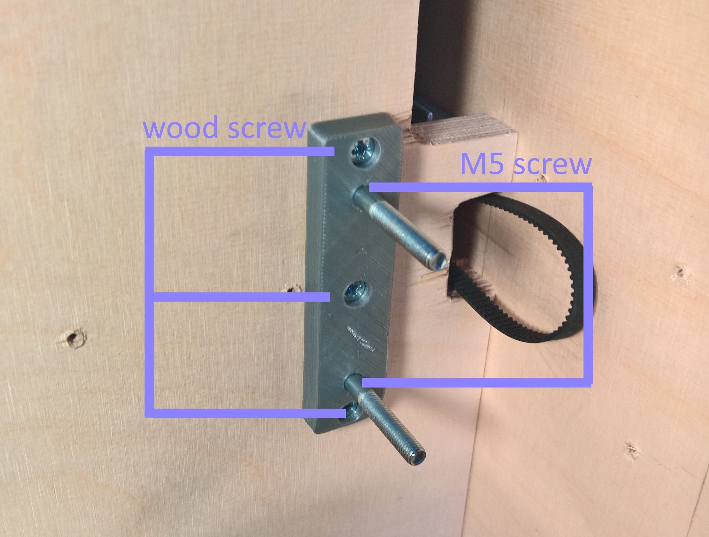

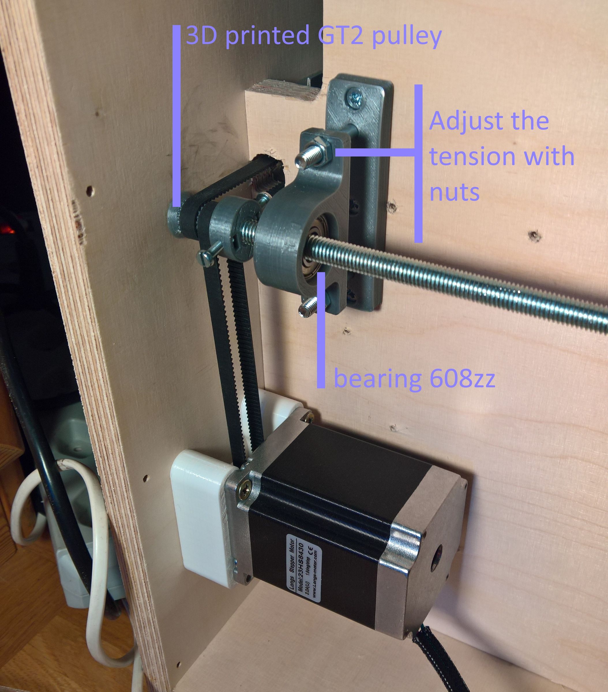

On the back, there is a system that connects the two belts to one stepper motor through a shaft. The shaft is a M8 threaded rod but you can use whatever you want but it is cheap and do the job. It rotates in 3D printed parts that can ajdust the belt's tension. The first part is mounted with 2 wood screw and two M5 screw that will enable the second part to connect to it and ajust the tension. The wood screw prevent the M5 screw to rotate because they tight the plastic.
Then the second part is mounted as well a the support for the stepper motor

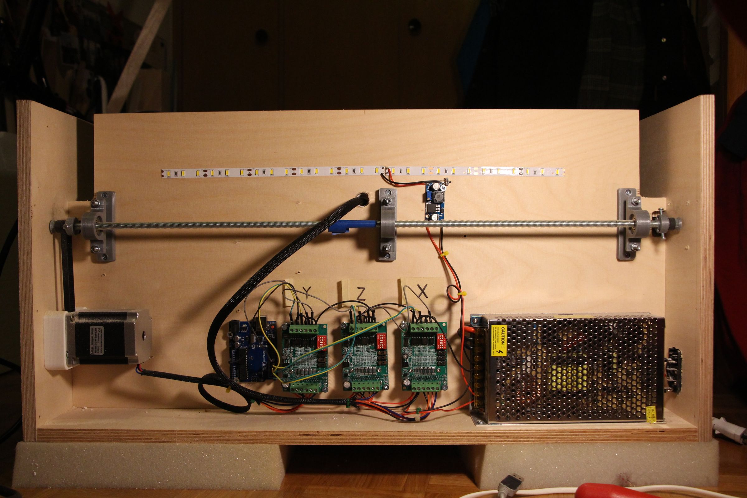

Step 7: Electronics
A cnc machine require only a few electronic components :
- Power

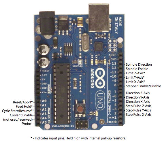

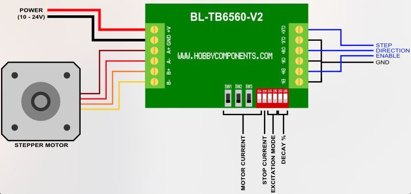

- Stepper driver → TB6560
- Gcode interpreter → Arduino uno
I will be using GRBL 0.9 with is an Arduino sketch available here. To upload it, simply follow the instructions on the website. It is very easy. It only require to upload a single sketch. Then connect the three stepper driver to the arduino by following those those images.
Note : I don't know what are the switches on the stepper driver for.
Note 2 : You will have to setup GRBL once it's on the arduino. It's important that 1mm in the code correspond to 1mm in reality. Everything is explained on the website.

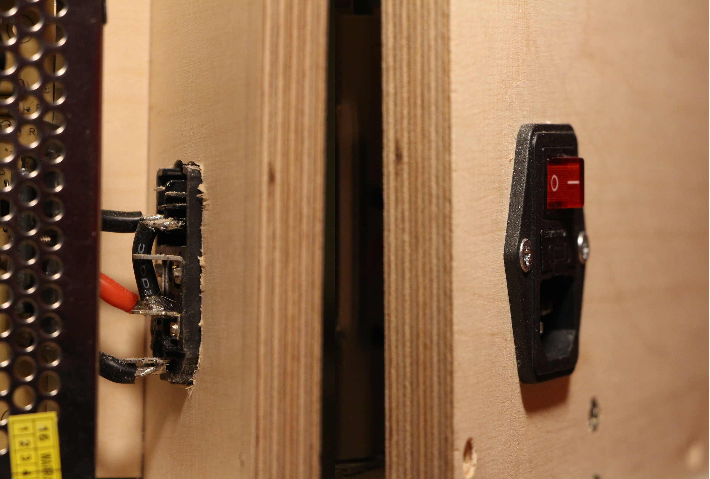

Then Power the stepper drivers with the power supply. I also used a plug socket with an interrupter. The arduino will be powered by the computer.
I decided to add some LEDs that light up when the machine is on. It requires a simple step down voltage converter and 40cm of white warm LED strip :-)

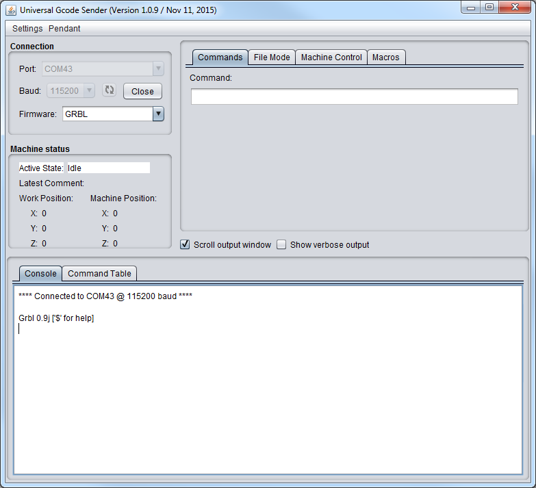

Step 8: Make It Alive!
Now that the electronics is done and that GRBL is on the arduino, our cnc understand Gcode with is a machine language that tells when the motors have to move basically. We will use Universal Gcode Sender to setting it up. Here is how we are gonna do it :
- First plug in arduino to a computer with Universal Gcode Sender installed.
- Launch it.
- Set baud rate to 115200 and select Firmware GRBL.
- Clic Open.
- This is what you should have :
Then configure GRBL with the help of those instructions. On the Machine Control tab, we can move the three axis and see if it works!

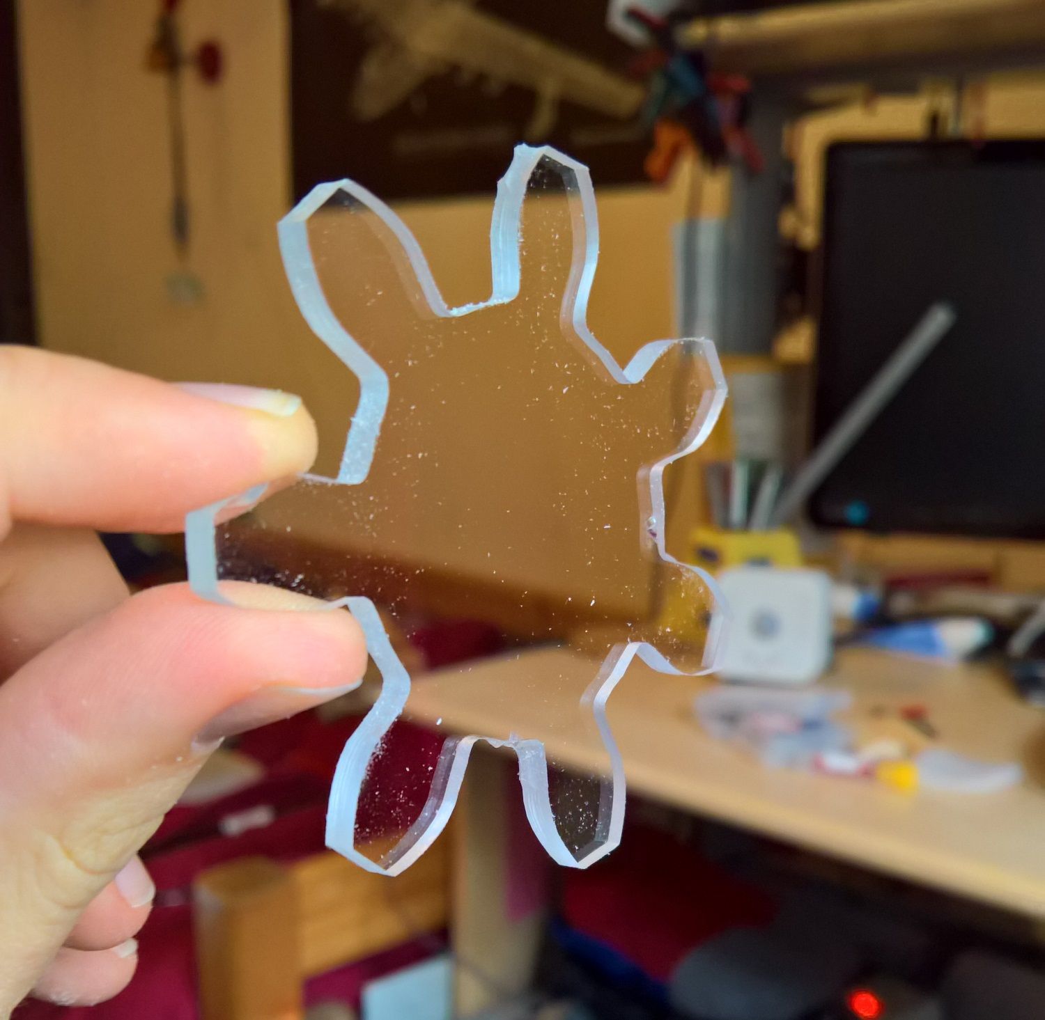

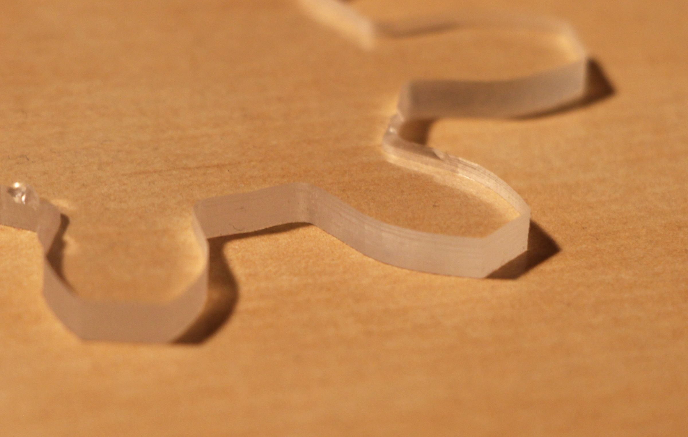

Well that looks great! How does it go with plexiglas ? Not that bad
For that I used Easel which is a free online CAM and CAD software developped by Inventables. It has built in GRBL support and work really well.
Then I tried to cut Birch wood and poplar wood and this is what it looks like :
