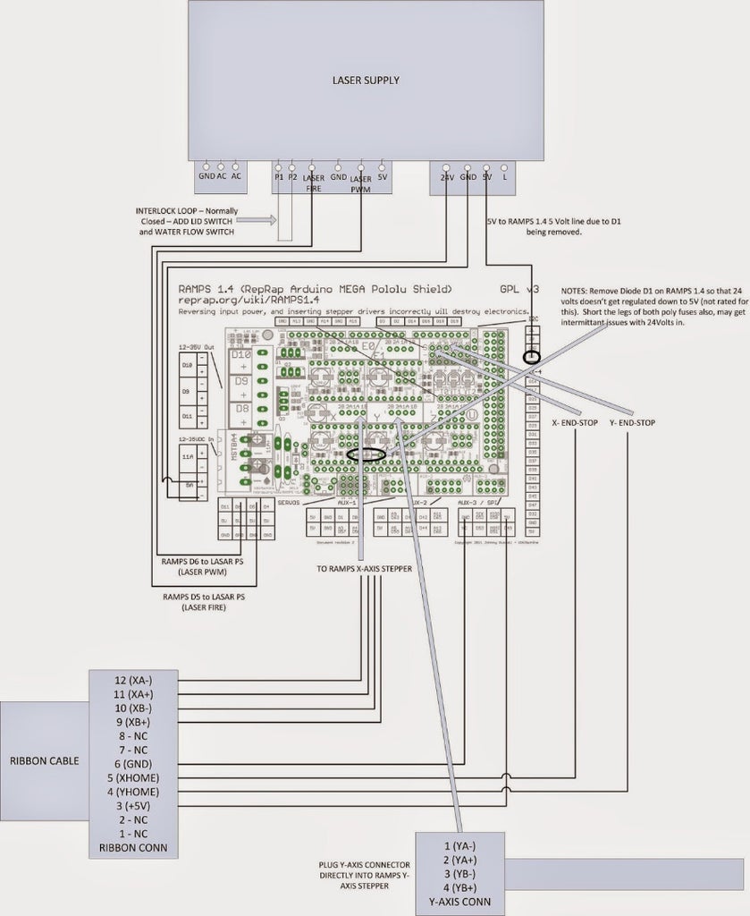

Step 4: Adding the Arduino
A huge thanks for doing all this hard work already goes to Dan Beaven who inspired my to try it myself.
Also without the work of Turnkey Tyranny we would not have a working firmware for our Arduinos or the Incscape G-code export plugin - great job!
Of course I also need to mention the great guys at the Lansing Makers Group who started all this pioneering work.
So don't be fooled to think I did all the hard work - thank those above for it!
To continue please prepare your RAMPS board so it can cater for 24V.
Check the Wiki page, in the power section you will find the location of the D1 and D2 diodes - D1 needs to be removed!
The two big, yellow plates are polyfuses and we need to short them with a lenght of wire so the board can handle the 24V properly if not done you might encounter random disconnections.
If you want to keep them for safety reasons please replace them with 30V types.
Now it is time to connect everything - I won't bother too much at this stage to make proper mounts an such as I still plan do some further mods to be covered in another Ible.
Please use the images from the last step as a reference, your internals might differ a bit but the basics are still the same, even if yours has a analog meter.
On the ramps board you need to check under the drivers if the jumpers are set correctly for 1/64 microstepping!
As it is the maximum these cheap drivers support you can put all 3 jumpers in there.
Dending on you skills and material at hand you will either use connectors or solder the wires without the right connectors directly - either I will only refer as "connecting" in this matter.
Check this nice diagram Dan Beaven made as a reference:
In my case there was no ribbon cable at all, just two identical connectors for the steppers, which caused me a bit of a headache at first.
To spare the headache use the above image a s a reference and do this:
The big cables between controller and PSU are the power supply, start with them and disregard the wire on the "LO" connction - you only need 5V, 24V and GND.
Only if your Laser power supply does not offer a PWM control you still need the power adjustment and the analog meter - plus make some minor changes in the firmware (documented).
Next connect the Laser fire and PWM signal wires - if your PSU is different check the circuit boards for the corresponding connections and use them.
Now do the stepper motors and if you have a ribbon cable for motor and endstops follow the above diagram, otherwise plug the motor in and prepare the endstop or cable to cater for pull up resistors.
If you are unsure about this step check this Wiki for the wiring details of the resistors.
Connect the endstops to ramps board, 5V and GND - it does not matter which 5V terminal or ground terminal is used here.
There is a chance your stepper motors will run in the wrong direction, if that happens simply put the connectors on in "reverse".
That should be the electronics for now, display with full motion control will be covered in the next Ible.

Right now all should be mechancially good on your end, the electronics back in the machine and all wiring double checked.
Time to get the software part working...
