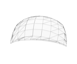

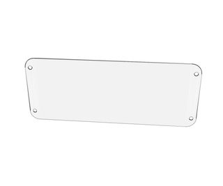

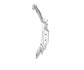

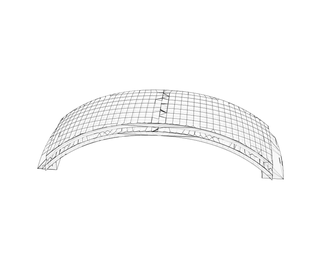

Step 2: 3D Printed Part Files
Some parts will require rotation and/or support material. You will require the following parts in white PLA:
  • 1 x Case
  • 1 x CaseLid
  • 1 x HelmetBack
  • 1 x HelmetFront
  • 1 x HelmetLeftBottom
  • 1 x HelmetLeftTop
  • 1 x HelmetRightBottom
  • 1 x HelmetRightTop
  • 1 x HelmetTop
  • 1 x HelmetWirePlate
  • 12 x LEDBank
You will also require the following parts in natural (translucent) PLA:
  • 1 x LEDDiffuserLeft
  • 1 x LEDDiffuserRight
The Helmet and Diffuser parts may need scaling if your head is significantly larger or smaller than mine. For comparison, the circumference of my head is 55 cm.

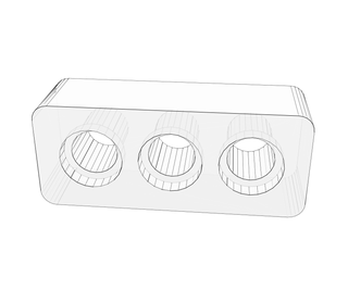

First, take your 12 3D printed LEDBank parts, and embed three LEDs of the same colour into each. Join the legs of each triplet of LEDs so that they are connected in series (be sure to get them the right way round - polarity is important for LEDs).
Solder some long leads onto the ends of each triplet, and join the positive and negative leads of each same-coloured triplet so that they are wired up in parallel.

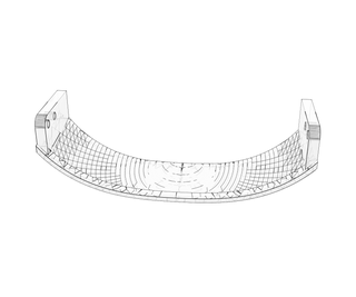

It's then time to use your hot-melt glue gun to attach each LEDBank onto the 3D printed LEDDiffuserLeft and LEDDiffuserRight parts. The LEDDiffuserLeft and LEDDiffuserRight parts should then be attached to the helmet using hot melt glue.
All of the positive leads can be joined together to a main power supply lead, which should be long enough to reach the control box (1 - 2 m). The negative leads of each pair of same-coloured triplets should each have a long wire (again, 1 - 2 m long) and should be wired to the appropriate points on your stripboard (refer to the earlier diagrams).
