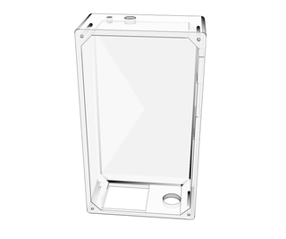

Step 2: MODIFYING THE BOX
*If you bought the project box linked in the BOM then you will have to cut out some holes for the parts. Since the box is just ABS plastic, a Dremel tool with a cutting wheel is my preferred choice for making the square holes. I used a dull pocket knife to clean up the edges. (The dullness was actually good for this because it keeps the blade from digging too far in making it a good deburring tool.)
*Refer to the attached PDF file in this step for exact hole dimensions and locations.
*I've also attached a reference of the standard sizes of process controllers. The model I've provided in the BOM is the 16 DIN. The main selling points for the larger standard sizes is that they have larger screens and buttons, more current capacity, more switched connections and alarms, basically more of the same stuff except bigger.
*I made stl files if you want to try to 3D print the box, but it is a bit big for most consumer grade 3d printers.
