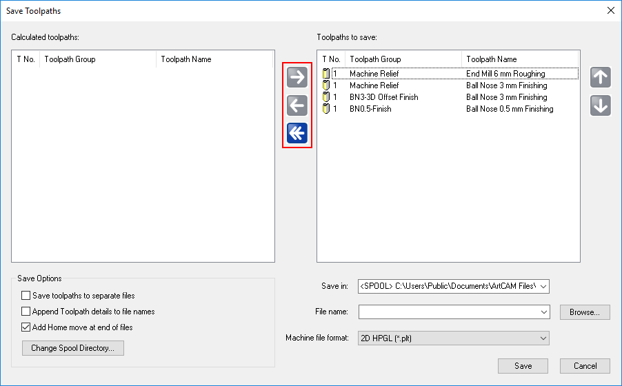

When the Save Toolpaths form is opened all existing toolpaths are listed in the right hand window (as Toolpaths group was highlighted). Toolpaths are selected and transferred from one side to the other using the central Arrow buttons as highlighted above.
All the files in the right hand window (Toolpaths to save/post process) will be included for output into a single NC data file. If the machine tool uses a manual tool changer then it will only be possible to include Toolpaths in the NC data file that share the same cutting tool.
If the machine tool has an automatic tool changer then any combination of the available toolpaths can be include in the NC data file (as long as the selected machine supports it).

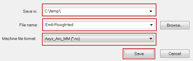

3 Browse… to a suitable location (e.g C:\Temp)and enter File name as Em6-Rough-ted.
4 Select Open on the Browse window to return to the Save Toolpaths window.
5 From Machine file format select Axyz_Arc_MM(*.nc).
This machine does not support an automatic tool changer hence only Toolpaths that use the same tool can be included in the ncdata output file.
6 Select Save to post process the Toolpath.

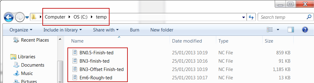

11 Browse to the C:\Temp directory to see the saves toolpaths.
All the post-processed Toolpaths have been saved outside ArtCAM and translated in the format required for an Axyz machine controller. These files can now transferred to the machine controller itself, ready for manufacture.
If the Toolpath itself is modified within ArtCAM, the above process must be repeated for that specific file.C:\Temp as a location is not recommended for production. A structured folder system according to best practice must be utilised.

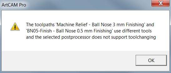

If toolpaths containing different tools are passed over to the right hand window of the Save Toolpaths form and the selected Post Processor does not support an Automatic Tool Changer then a box with an error message will appear.
1 Using the arrow Transfer all the toolpaths into the right hand window as shown.
The Vertical arrows can be used to reorder the toolpaths for a single output file.

The operation has failed and the above error message appears. The files were unable to be processed for two reasons.
  • The selected Machine (post processor) does not support tool changing itself.
  • All tools are currently identified as Tool number 1. The Tool Number is essential to identify the location of an individual Tool in the tool changer or carousel.
