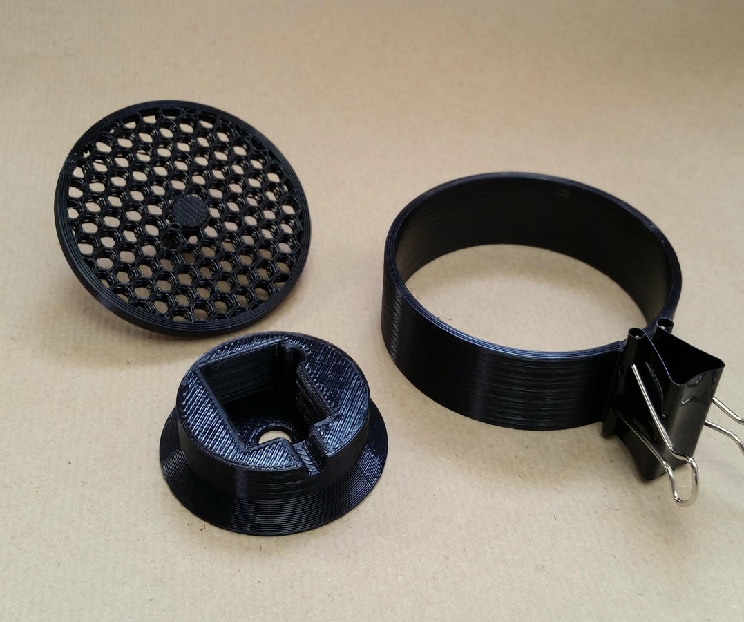

STEP 2: Design and Print the Knob:
First step will be to design and print the enclosure and knob for your customisable controller.
I will be including three different designs one is a printed inner with a mold to cast concrete into for a stylish weighted controller and the other is for a fully 3D printed version that is easier to make but because of its light weight it tend to move around alot and will probably need some sticky tape on the bottom to keep it at bay. The third simply has space on top for a 3mm acrylic circle which an LED can be fitted to for some extra style points!
The components were designed using Fusion 360 and is super easy to print in any filament with no supports needed.
I have included the step files as well as making it available on Tinkercad for easy customization to suit your needs.

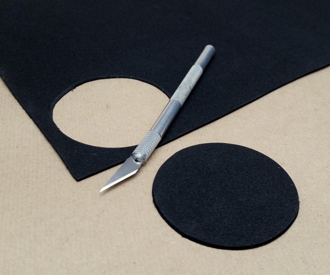

STEP 5: Refine the Enclosure:
With our concrete base made we can start refining the enclosure.
I started by sanding down the surface of the button to give the filler a coarse surface to grab onto. I smeared the entire button with a thin layer of filler before sanding with 220 grit sandpaper and priming.
Once the primer has dried completely we can wet sand it with 400 grit sandpaper and move on to the final spray painting.
I chose to spray mine with this beautiful gunmetal color with my airbrush that almost makes it look like a casted metal piece. Now set it aside to dry completely.
Next up I sanded the concrete a little to soften the edges and I also used a drill bit scrape a slot into the concrete for the cable to lay in.

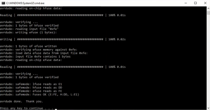

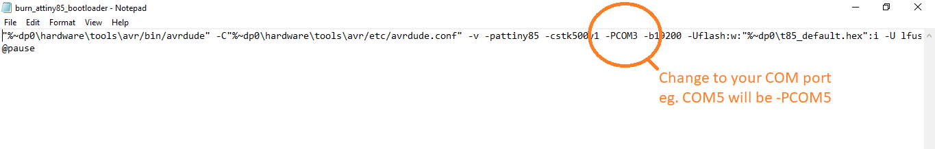

STEP 7: Test the Electronics:
Before soldering anything we want to make sure the electronics work.
If you haven't used a Digispark Attiny85 board before you will need to install it's drivers and install it onto the Arduino IDE which I will go over in the next step.
I first uploaded a simple blink code onto my Digispark board to make sure it was functioning correctly.
Then I uploaded the code and unplugged it when it was done.

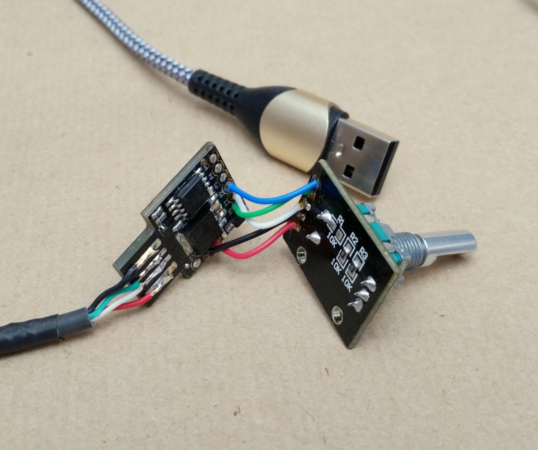

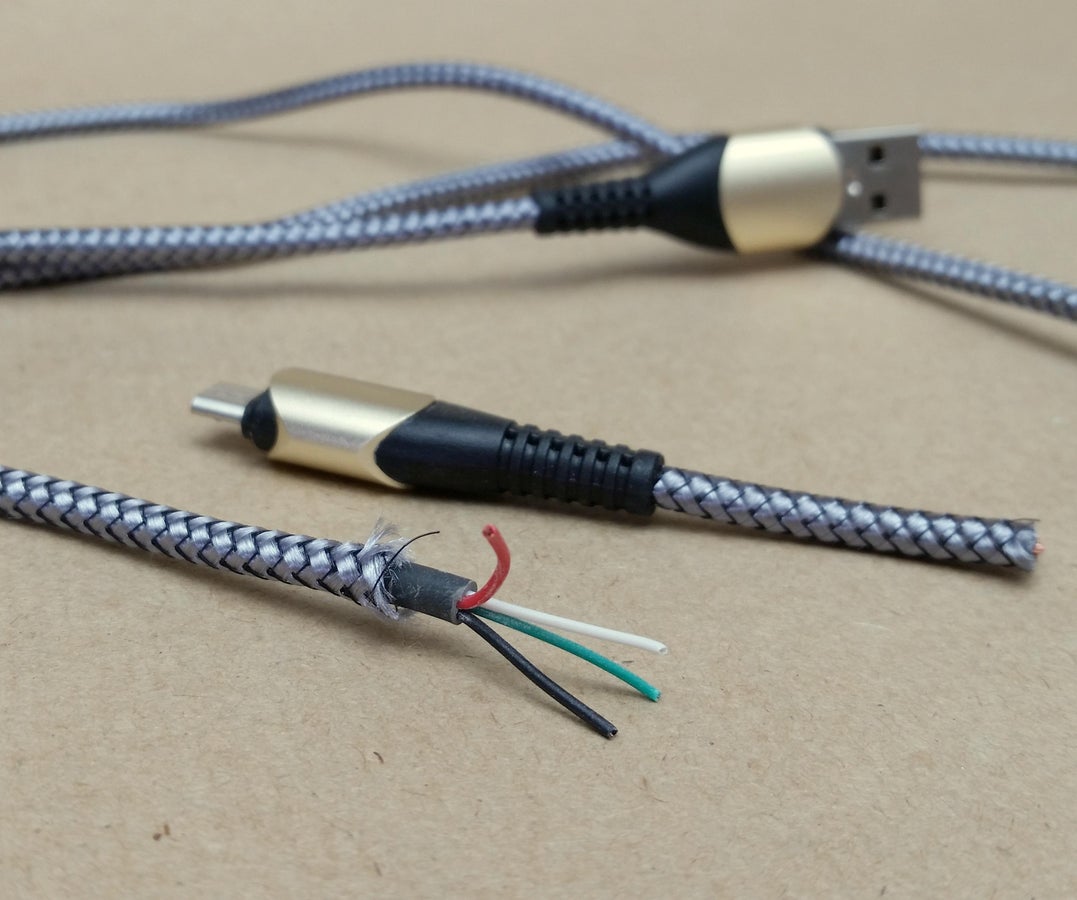

Next connect the Digispark to the rotary encoder with jumper wires as follow:
Digispark to KY-040
P0 to DT
P1 to SW
P2 to CLK
VCC to GND > This is not a mistake
GND to 5V ^
Once connected plug it into your computer and see if turning the rotary encoder adjusts the main volume.
If it doesn't work as intended double check your pins or change the pinout in the code to one following:

STEP 8: Fix Digispark (Attiny85) "USB Device Not Recognised" Message
If you are receiving the infamous "USB Device Not Recognised" pop-up when inserting the the Digispark/Attiny85 board into your computers USB port you can try the following which fixed all of my previous unusable Digisparks.
- First you need to make sure you have the Digispark drivers installed that is included in the download below.
- Then your Digispark has to be included on the Arduino IDE.
- Open the arduino IDE and go to file > preferences.
- Add http://digistump.com/package_digistump_index.json to the additional boards manager URLs.
- Go to tools > board > boards manager.
- Search for digistump, and install Digistump AVR boards.
- Then you will need an Arduino board (UNO/Nano etc.) with the "ArduinoISP" sketch loaded that can be found under "Examples".
- With the code loaded connect your Digispark to the Arduino as pictured above via jumper wires.
- In the downloaded folder under "Attiny85 Firmware update" open the" t85_default.hex" file using notepad and change the COM port to the port your Arduino is plugged into as shown in the picture below, Save the file.
Drivers and Firmware Update LINK
- Next copy both the "t85_default.hex" and "burn_attiny85_bootloader.bat" files over to your main Arduino IDE installation location eg. C:\Program Files (x86)\Arduino
- Now run the "burn_attiny85_bootloader.bat" file.
STEP 9: Soldering:
With the electronics working as they should we can solder them together permanently.
Using short flexible wires solder each point from the Digispark to the rotary encoder as you had them connected with the jumper wires.
Next we need a USB connection.
Using a beautiful braided USB data cable I got from a bargain bin sale I snipped off the micro USB side of the cable and exposed the wires.
Solder the wires from the USB cable onto the Digispark as shown in the picture below.
Last piece to solder was the LED that was soldered to the USB 5V through a 100ohm resistor to limit the current going to the LED.
Plug in the USB into your computer to make sure everything still functions correctly.
STEP 10: Assembling:
It's finally time to ensemble your multimedia button!
Start by pushing the rotary encoder through the 7mm hole in the top of the enclosure and tightening it with the included washer and nut.
Next I pressed the Digispark into place underneath the rotary encoder and used some hot melt glue to keep it in place. (I still need to modify the design to include a lid but will update here when it is completed)
To protect my desk and keep the button from slipping I cut out a disk of thin black foam (sold at craftshops as kids party foam) and glued it to the bottom of the button.
Now simply push on the button cap and your multimedia button is done and ready for work!
