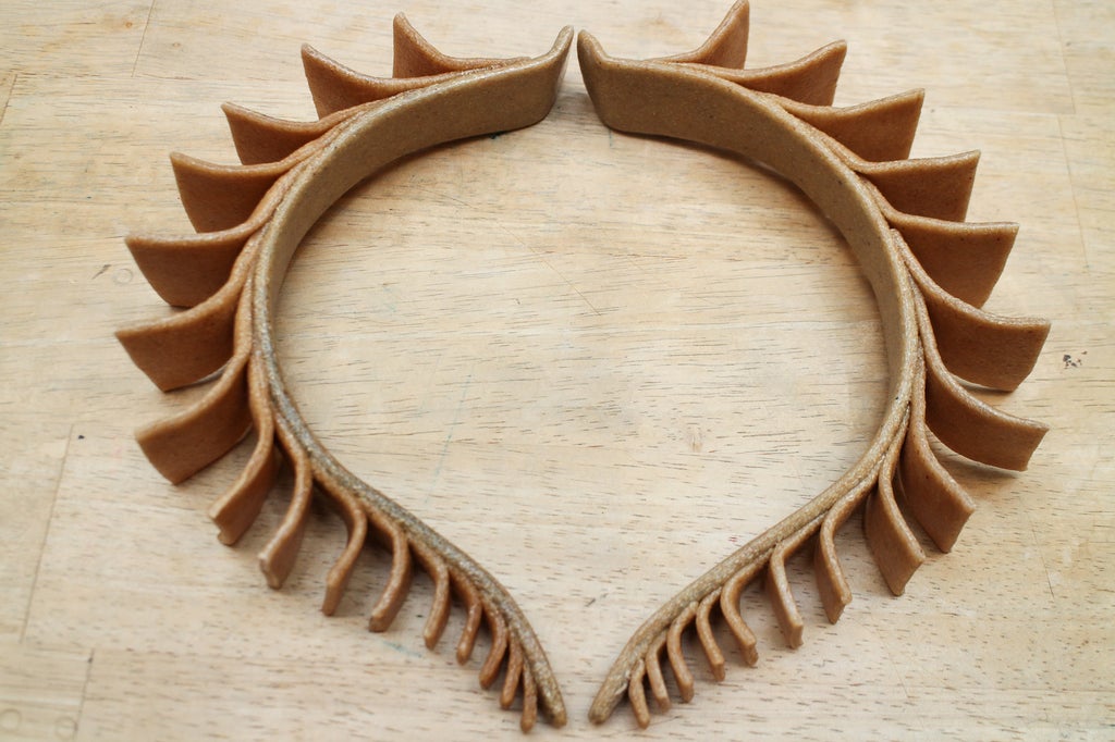

To add your detail pieces you need to heat both the base and the pieces you are adding. I think it often works best to create sections of details separately and then add them to your piece all at once. Once a piece of Worbla has adhered to itself it's really difficult to get it off without damage, so mistakes can be hard to undo.
Something I really like about Worbla is that you can also use details to cover up mistakes or seams, like I did on the top dart of my helmet.
At this point you are really just sculpting, so you can use all kinds of different techniques depending on what kinds of details you want to create or what material you are trying to emulate. If you are trying to create something realistic it can be helpful to look at reference pictures as at this stage.
For example, if you want to create something that looks like it was made out of sheet metal, you should probably cut shapes out of flat sheets of Worbla. One sheet of Worbla is really quite thin, so I often sandwich from 2-4 layers together with to create a lot of my detail pieces. Heat each layer and roll them together with a rolling pin to get a nice flat piece.
If you want to create something that looks like it was carved or sculpted you can use your Worbla more like clay, mushing it together, rolling it, shaping it, or even pressing it onto something that has a texture!
You an also use tools on your details once they are in place to shape them further.
Most details won't require more foam sandwiching, but if you are adding another large structural layer, like I did on my bracers, it can be a good idea.
I also used a foam core in the antennae of my moth headpiece. First I created the base pieces and formed them into a curve I liked with a little tab at the bottom that would be the attachment point to the helmet.
The texture of the antennae was created by cutting pieces out of triple layers of Worbla and sticking them to the base one by one.
When I had both antennae made, I heated them and then stuck them to the helmet.
