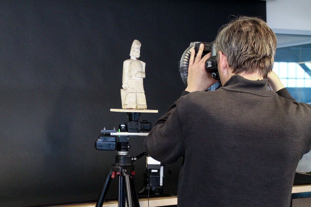

To shoot a rotating object, you need slightly more equipment. First of all, you will need some kind of manual rotating turntable or lazy susan to place your object on. Depending on how large or heavy your object is, you will need a different sized turntable. You could also make your own fairly easily by following this Instructable by the awesome tomatoskins.
When you are shooting a rotating object, you need the background to be as featureless as possible (I'll explain the reason for this later) so you will need to shoot against a seamless backdrop, a sweep, or inside a shooting tent. Black backdrops tend to work best unless your object is especially dark.
For this method you absolutely need a tripod to hold your camera in one place and some kind of lighting set up like the one described above. Another good lighting option for this type of shooting is a ring light that goes around your camera lens.
