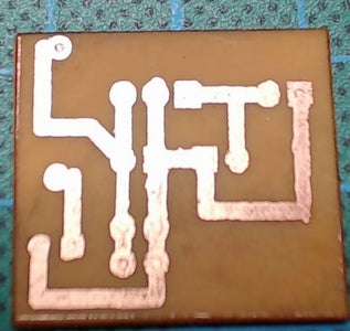

Using whichever etching technique that you prefer, etch the circuit and test it.
I've taken to using thick traces to improve the circuit etch results. They could just as easily be thin ... it's just preference.

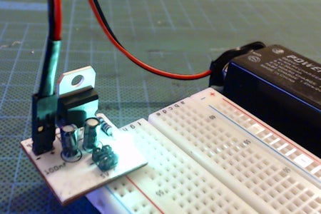

When populating your board. I start with the pin headers. The input pin headers are inserted normally and are soldered in at the top left of the board.
The connection pin headers are pushed all the way through the board so that the plastic pin header housing doesn't have any pin protruding. The pins are on the copper side of the board because that's how you plug the circuit to the breadboard.
After the pin headers, I solder the resistor and LED followed by the 2 x 100nF capacitors. Note the orientation of the capacitors, these are polarized electrolytic capacitors with the negative sides facing each other on the board.
The LM7805 is then soldered into it's holes. I needed to increase the hole size for the Reg because the legs are wider than the other through-hole components that I've used.

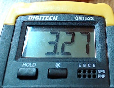

If you want to make a 3.3v reg, simply replace the LM7805 with a 3.3V regulator (such as a UA78M33), everything else in the circuit is the same, remember, though, that more voltage is being dissipated, so the heat sink on the module will get hotter.

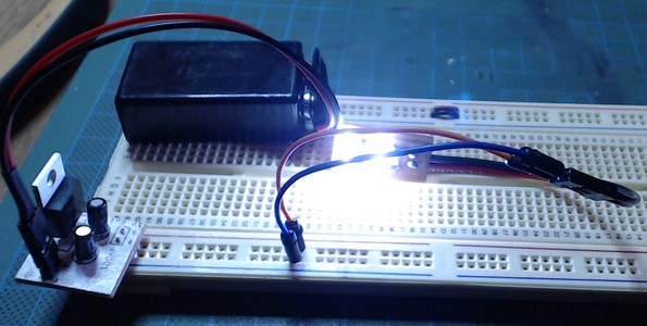

Now, you can plug the module into your breadboard and connect the power. When the circuit is powered, the LED lights up.
I thoroughly recommend testing your power supply using your multimeter. Above are the results for LM7805 and UA78M33C regs.
