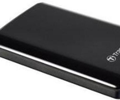

Step 6: Packaging
Packaging is always fun.. Just pick-up whatever you could come up with from the mighty treasure junks... you can make wonders...
