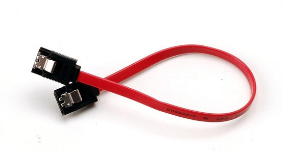

- SATA Power supply Cable
- SATA Data cable

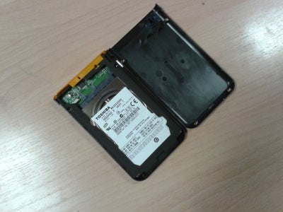

Step 2: Pry It Out... Take Apart..
Now having acquired all those items.. just do it...
Unscrew the only star screw behind those stickers and pry open the top lid using the flat faced screw drivers.
NOTE: It might demand some effort to separate the lids for it would've been made of press-fitted plastics which may not be re-usable if you damage it physically

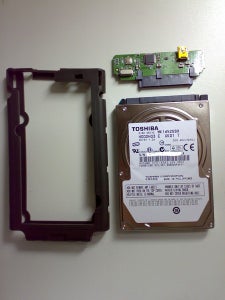

You should see the real prize inside in the form of a miniature HDD which is originally SATA.. Now remove all parts and take apart for the real Magic to follow..
Unplug the SATA to usb PCB from the fixture and remove the bumper case as shown in the picture

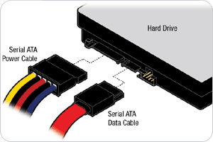

Push those SATA power supply cables and data cables in the Mini-HDD Gently for it'll be too flimsy to be damaged easily with all that we've done thus far..
put the other end to the spare plugs coming out from the SMPS and to the other SATA slots in the Motherboard
