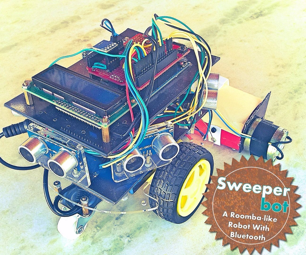

UPDATE: CHECK OUT MY OTHER TWO PROJECTS >>
SweeperBot - Roomba-like Robot With Bluetooth
