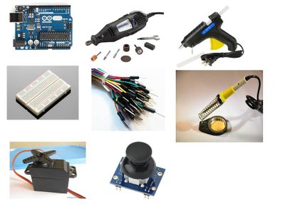

Step 1: Materials
Most of the materials were bought @ RADIOSHACK
Arduino Uno X1
Bread board X1
Servo Motors X4
Parallax thumbsticks X2
Prototiping wires (see the pic) X around 26 of them
Hot Glue Gun X1
Dreamel tool (or similar one) X1
A plastic school supplies box X1
