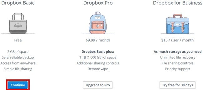

Step 4: Select a Dropbox Package

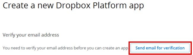

Step 5: Email Verification

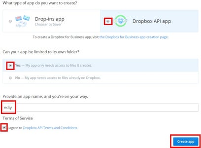

Step 6: Select Type of App
Step 7: Record Down the Permission Type, App Key and App Secret
