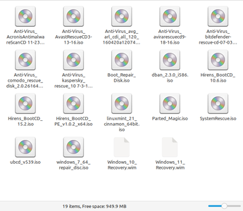

Step 32: Hard Drive Wiping Software Running
I went with DBAN (Dariks Boot and Nuke v2.3.0) from Ultimate Boot CD (UBCD) v5.3.9 to wipe this hard drive. UBCD comes with lots of different options to choose from for wiping this is just one that I have used prior and had no issues with it. I installed Ventoy and lots of other recovery tools as well so it would be very versatile and fill up the whole USB flash drive. This was to get it ready as quick as I could but in the future I will have it organized into folders with better file names as ventoy auto detects folders. It takes a few hours to wipe with DoD Short 3 passes and this was only an 80GB drive. But that was to be expected.

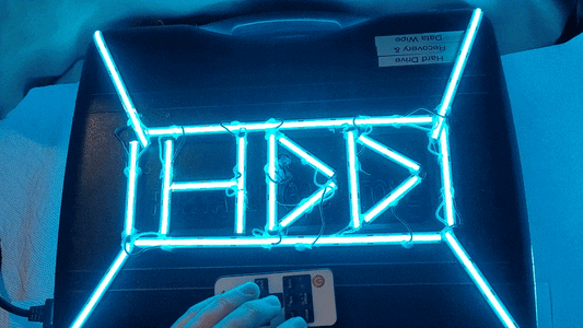

Step 41: Spell Out HDD With Glow Strips
Last make it spell out HDD inside of the rectangle using the glow strips. Since you can only cut on the solder points I used triangles to make the D’s. You could try to bend the strip in some way but it was too rigid for me to do that without breaking them so triangles worked.

Step 46: Make It Glow, Tron Style
With all the soldering complete and the soldered parts covered with hot glue so nothing comes undone or gets shorted out if the cable moves its time to make it glow. It took a lot of soldering to get to this point so I hope you enjoy how it turned out! The pictures make the wires and individual LEDs a lot more visible then they actually are in person. Also this is extremely bright since it is 12v but it does look really cool!

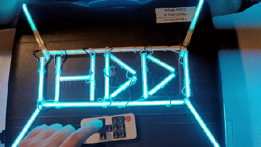

Step 47: Update: Add LED Controller
Here is a needed upgrade to this project with a cheap LED controller that can control brightness and a can do a few effects. This looks really cool as is but the brightness level is blinding enough to need sunglasses without a controller. For this upgrade first cut off the barrel plugs and stripping the wires and strip the wires of the 2-pin connectors. Then put heat shrink tubing on both wires and a bigger one to go over both at the end, solder the red and black wires to the red and black wires on the power side and LED side. Shrink the tubing, plug it in and you are good to go. If you didn’t do the 2 pin version I highly recommend you get this barrel plug adapter instead and it fits right into this LED controller no soldering required and plugs into the molex of the power supply.
Step 48: Update: LED Controller, Brightness Control
Here are a few pictures of the brightness control of the new LED controller. I also took a video of the brightness levels and a few of the effects at full speed. They are attached here as a GIF with very low frame rate which helped reduce the horrible flickering the camera picks up that the naked eye cannot see. The brightness level is much more noticeable in person as the camera also seems to auto adjust its brightness.
