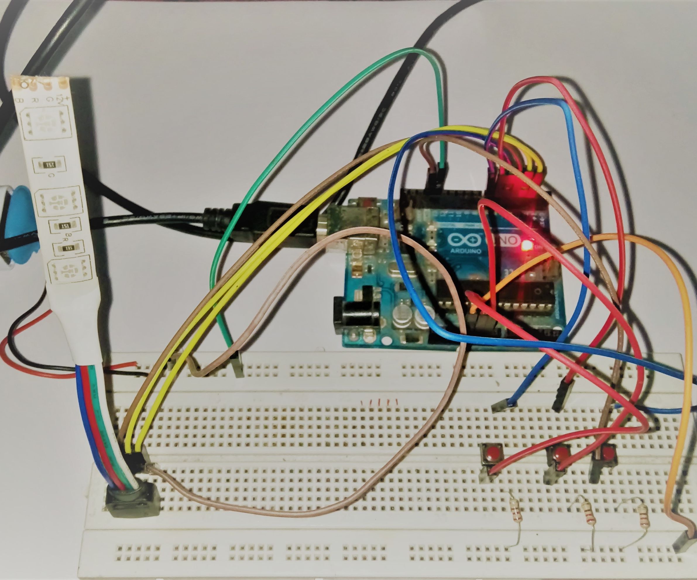

The very first project of my channel is about controlling an RGB LED using annoying push buttons.... I feel that the project was not a good one to learn about micro-controllers, because most of the micro-controllers uses are not fully utilised in that project....
So, This is definitely the time for an upgrade, and upgrade means letting the micro-controller to work with at least few of the features.... The micro-controller used here is an Arduino UNO which has nearly 13 Digital pins and 7 Analog pins....
