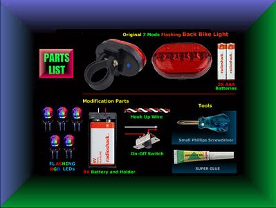

Step 2: THE PARTS LIST:
THE PARTS LIST:
The original 5 LED BACK RED BICYCLE LIGHT - found on EBAY here:
5mm 2 Pin - 7 Color LED Bright - 20000 Mcd - found on EBAY here:
9VDC BATTERY HOLDER - found on EBAY here:
9VDC BATTERY:
http://comingsoon.radioshack.com/search?q=9v+battery
(5 pcs) Switch ON/OFF SS12D00G3 1P2T Small Size - found on EBAY here:
TOOLS:
Small Phillips Screwdriver
Soldering Iron
Solder
Hook Up Wire
Super Glue

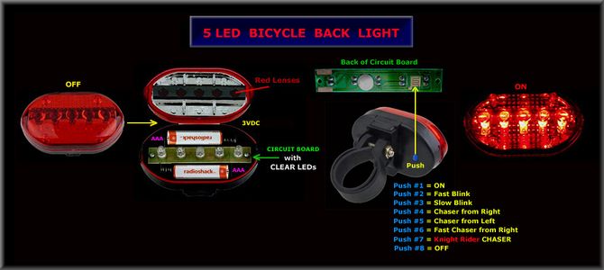

Step 4: ORIGINAL 5 LED BICYCLE BACK LIGHT OPERATION:
The original 5 LED Bicycle Back Light – when opened – takes qty 2 AAA Batteries.
The 5 LEDs are clear but produce a bright Red Light through the Red Lenses
when illuminated through the upper front plate.
The Push Button contacts an integrated circuit which switches the light
to produce 7 different modes as described in the picture above.

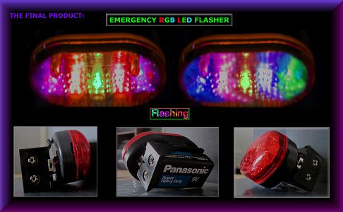

Step 6: THE FINAL PRODUCT:
The FINAL PRODUCT is now ready to use.
Turning the on-off Switch to ON will begin the flashing cycles of all individual
IC CHIPS inside each of the 5 RGB LEDs.
Since each of the 5 LEDs do not activate at exactly the same time ....
.... the combination of color patterns seen is in the thousands.
I produced this flasher to be used as an EMERGENCY ROADSIDE FLASHER
for any vehicle having a breakdown .
