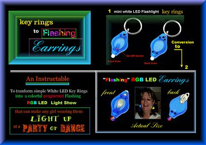

Step 1: PROJECT PREVIEW
The image above is a preview of what the original mini white
LED Key Ring Flashlights look like as opposed to the resulting
"FLASHING" RGB LED EARRINGS.

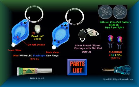

Step 2: THE PARTS LIST
PARTS LIST:
The original mini white LED FLASHLIGHT Key Rings - found on EBAY here:
http://www.ebay.ca/itm/LED-Mini-White-Keyring-Keychain-Flashlight-Torch-Light-/320639252073?pt=Lamps_US&hash=item4aa796b669
The Flat Pad Clip On Earrings - found on EBAY here:
http://www.ebay.ca/itm/10Pcs-Grid-Flat-Pad-Clip-On-Earring-DIY-Gold-Silver-Br-onze-etc-R344-03-/251143243920?pt=LH_DefaultDomain_0&var=&hash=item3a794dc890
The 5mm - 2 pin - 7 color - Bright Flashing RGB LED bulbs (with internal IC chip) - found on EBAY here:
http://www.ebay.ca/itm/50-5mm-Bright-2-Pins-7-colors-20000-mcd-LED-Bulb-Light-/280999773088?pt=LH_DefaultDomain_0&hash=item416ce443a0
The white - flat back - Half Pearl Beads - found on EBAY here:
http://www.ebay.ca/itm/New-ABS-Faux-Imitation-White-Pearl-Half-Pearl-Seed-Beads-Flat-Back-Tear-Drop-/261035300266?pt=LH_DefaultDomain_0&hash=item3cc6ea95aa
10 Extra CR2016 Lithium Coin Cell Batteries... - found on EBAY here:
http://www.ebay.com/itm/New-10-X-3V-CR2016-ECR2016-CR-2016-Coin-Cell-Battery-I1-/380320825040?ssPageName=ADME:L:OC:CA:3160
Note: - (Qty 2 CR2016 batteries are included in each LED Key ring)
*** SUPER GLUE
*** Small Phillips Screwdriver

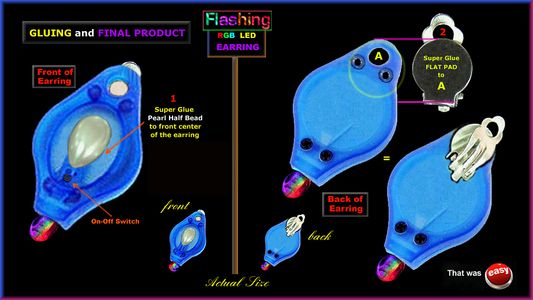

Step 6: GLUING and FINAL PRODUCT
All that's left is to super glue 2 pieces to the earring.
* Super Glue the PEARL HALF BEAD to the front - center of the earring.
* Super Glue the FLAT EARRING PAD to the top - back portion of the earring.
Repeat all these steps for the SECOND EARRING and you now have a
completed pair of " FLASHING RGB LED EARRINGS " ready to wear.
