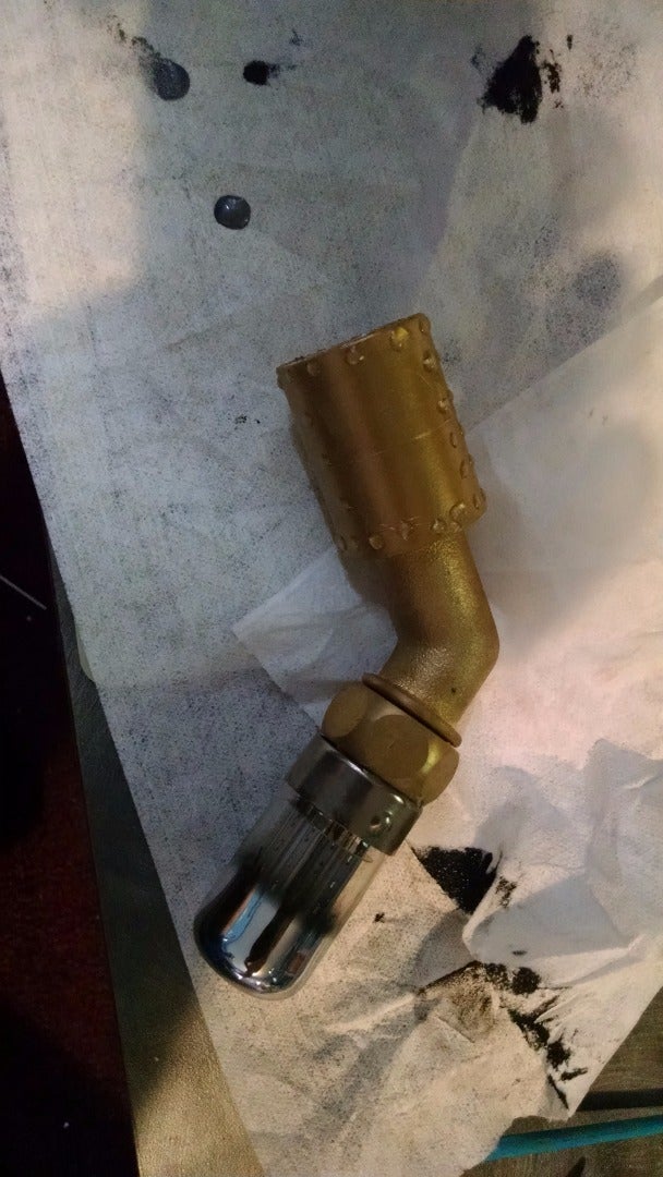

Step 5: Assemble
hot glue the brass fitting, the pvc fitting and the vacuum tube together
Step 6: Paint and Age
Paint it the colors you are wanting, allow to dry.
Now age it, just dry brush with some black paying attention to the edges.
I got a little sloppy with the epoxy and hot glue as you can see a little under the paint, just to give it a little character and a little aging
Step 7: Finish Your New Drive
You can now put the remaining 2 parts together.
I hot glued mine together, but you may have a way where it just slides in and out when you need it.
