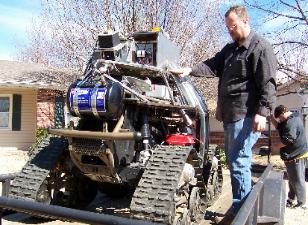

In this picture you can see all the systems completed. At the very top is the siren, and the signal light. Just below is the PC. To the right of the tan PC box is the small Black Cube, this is the scanning radar system. It would scan left to right and was mounted on an adjustable gimble to raise or lower the radar depending on the terrain. Forward of the radar is the reserve air tank. This was filled by the small on board compressor and was used for the breaking system. at the rear of the robot is the fuel tank. We added a larger 15 gallon tank for the long distance race requirements. this was tied into the  tank on board the ATV.
Step 3:
In this picture we were getting ready for race trials and testing of all the system at a secured location for safty. Love those tank treads...They were provided by our sponsor Mattrax. cost 5000.00. They are a very stable platform for the robot, they added massive footprint and a dramatic gain in traction on sand and dirt. well beyond a typical tire would. and the environmental Impact was greatly reduced due to the larger foot print of the tracks. Another feature of the tracks was the added gear reduction given to the drive train, this lowered the overall rpm of the motor given difficult terrain and helped lower fuel consumption in these difficult  areas.
