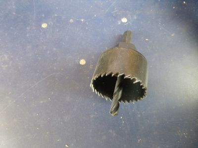

Step 2: Cut a Hole on Top
- Using a round cutting tool pit and a drilling machine, cut a hole of about 1-1/2 inches in diameter on top the coconut
- Remove the shell and coconut meat from the cut portion and drain out the water from inside the coconut.
