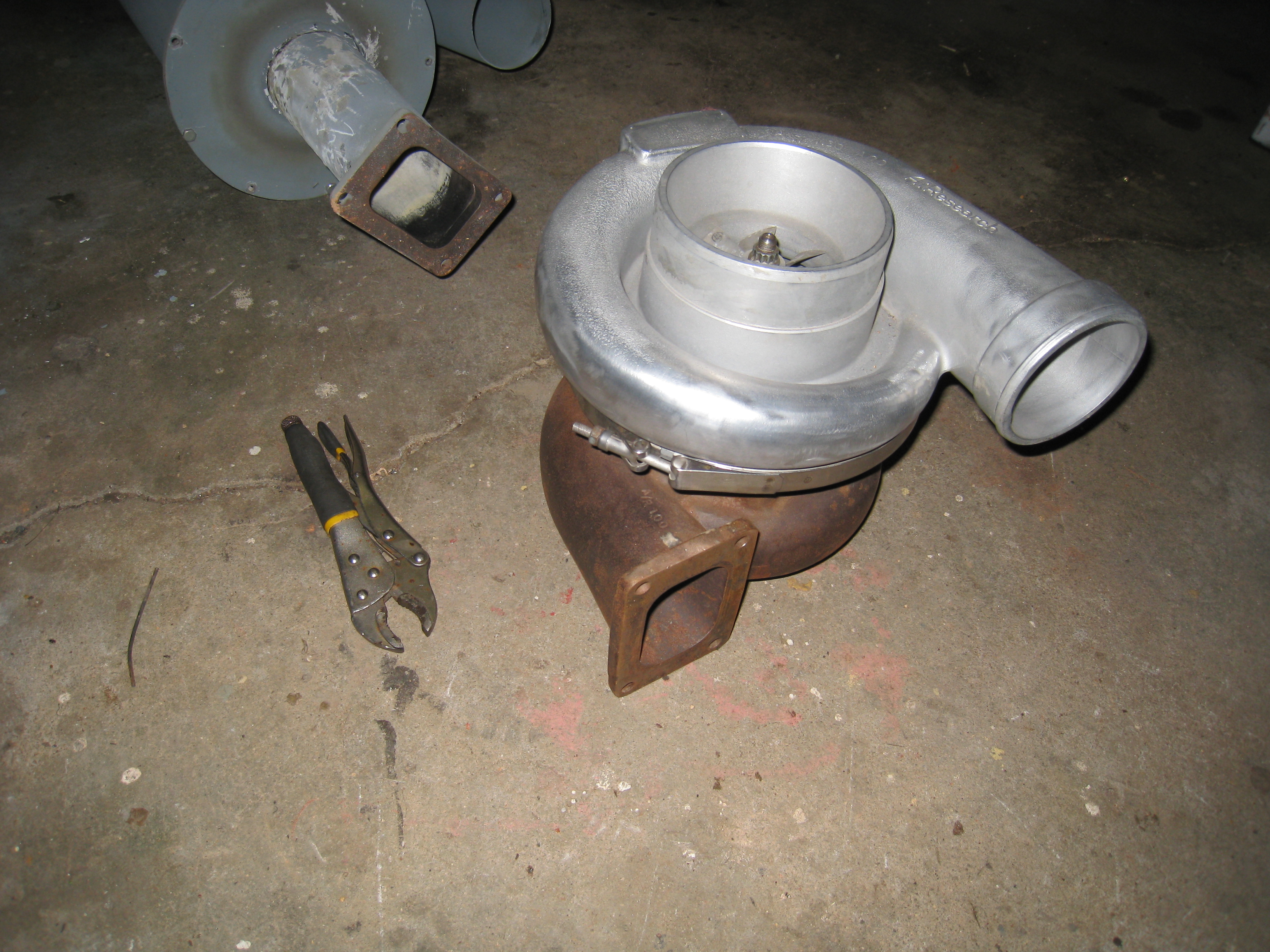

Hi all, this is a go kart which is powered by a home-made Gas Turbine (Jet Engine), it is the result of 6 months of planning and 3 months of building. The kart and the engine was all home-made thanks to some kind people who helped me find some hard to find parts.

Turbo: AI Research, 3.9 inch Inducer
EGT Running at idle: 550'c
Oil Capacity: 4.2L
Fuel start: LPG
Fuel Run: Gasoline
Compressor Pressure idle: 15PSI
Max Turbine Speed: 65,000 Rpm
