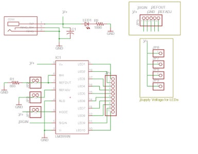

Step 5: The LM3914 Circuit

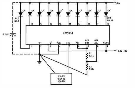

I chose to use the LM3914 for the control circuit on this build. If you are making strictly a VU meter, you might want to choose a LM3916 or maybe a LM3915 if you want a logarithimic scale. Simply put, the 3914 takes a reference voltage and uses a voltage divider and comparators to look at the input in order to tell which segments to light up. If you are inputting a signal that is 1/10th or the reference voltage, it lights up segment one.
Now it's time to think about what voltage we will need to drive this thing. Here is where the LED forward voltage comes in. Mine was 3.2V. I have 3 of these in series, so the total voltage drop across the strip will be 9.6V. That means that I needed a power supply larger that 9.6V. I had a 12V supply with enough current supply to do the trick. My LED's are rated for 60mA, but after testing brightness by lighting them up (using a resistor to limit the current, do not exceed rated current!), I decided that 15mA was plenty bright for my application. This means that with all segments lit up, I will be drawing (10*15mA) 150mA plus a little extra for the LM3914. Look at a datasheet for the LM3914, it discusses how to use the chip to set the current draw through the segments.
If you take a look at my schematic, you can see I use three jumpers. I wanted to make this design flexible in case I wanted to change my reference voltage or the mode of the light bar. If JP2 and JP1 are jumped, this sets the reference voltage to the 1.25V generated by the LM3914 and the segment current is controlled by R1. If a different reference voltage is desired, the jumpers are left off and the voltage can be set with an external circuit by wiring it to the REFOUT, REFADJ, and GND terminals (consult the datasheet to see how that works). JP3 jumpered puts the controller in graph mode, no jumper sets it to dot mode. I have RLo (Reference Low) hardwired to gnd, but now I am thinking that I should have made that an option too. I suggest breadboarding it out first to make sure everything looks good before you continue. KEEP IN MIND, the LM3914 is sinking the current, not supplying the V+ to the LEDs. The cathode side goes to the controller and the V+ is wired to the anode side. To check operation, you can use a potentiometer. With JP1,2,3 jumpered, you can connect one side of the pot to GND, the other to REFOUT, and the wiper of the pot to SIGIN. As you turn the pot, it should adjust the voltage on the input pin and light up the segments accordingly.
