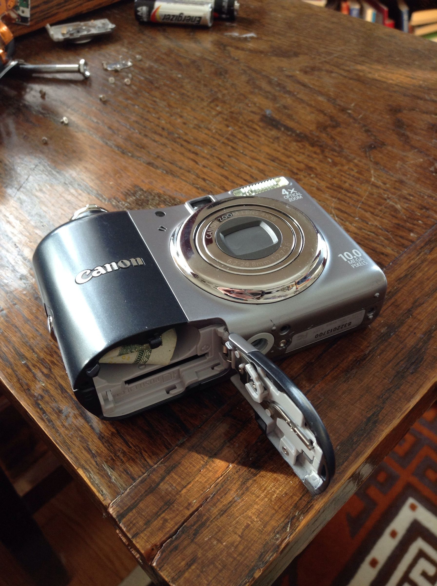

Step 3: Take Your Camera Apart Part 1
Take your screwdriver and take out all the screws holding the exterior on the camera. There are many hidden ones, so be diligent. Then, take off the exterior shell. It should look like the picture.
