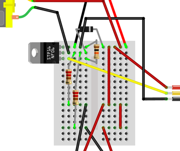

Step 2: Prototype the Circuit
It's a good idea to prototype the circuit on the breadboard before you permanently attach the whole thing inside the pumpkin. This will give you an idea of how it works, and you can make sure you have all the connections correct. Working inside the pumpkin is a little cramped, so you want to get any issues sorted out beforehand.
If you know how to read a circuit diagram, you can follow the schematic above (and if you don't, SparkFun has a nice guide on how to read a schematic). If not, follow the breadboard diagrams (made with Fritzing, and the Fritzing file is attached to this step). Space gets a little cramped on the mini breadboard, so pay close attention to each connection you make. It's also a good idea to make sure the battery pack is OFF as you put things together.
Once you've assembled everything, turn the battery pack on. The LEDs should light up and your motor should spin for a few seconds before stopping. The PIR sensor always turns "on" for a short period of time when it first powers up. Give it a couple more seconds, then wave your hand in front of the PIR sensor. This should trigger the LEDs and motor again.
If you want to learn more about how the circuit works, here's some recommended reading about some of the components:
- Adafruit has a nice tutorial on PIR sensors. When the sensor detects motion, it outputs a logical HIGH signal (5V). When it doesn't detect motion, it outputs a LOW signal (0V).
- Here's an introduction to LEDs, tiny lights found in tons of electronic projects.
- Here's introduction to resistors, which help limit the amount of current flowing through the LEDs so they don't burn out; and an explanation of what that 10k resistor is doing in there (in this case it's a pull-down resistor, not pull-up, but the concept is the same).
- MOSFETs are a little more complicated (if anyone finds a good kid-friendly resource, please let me know). Essentially they act like an electronically controlled valve that determines whether or not current can flow through the LEDs and motor. The output from the PIR sensor triggers the gate pin of the MOSFET. When the gate receives a HIGH voltage, the MOSFET turns on, allowing current to flow. When the gate receives a LOW voltage, the MOSFET shuts off, turning off the LEDs and motor.

Step 6: Assemble the Circuit Inside the Pumpkin
Now for the tough part: you need to assemble the circuit inside the robot. Again, kids with smaller hands might have an easier time than adults here. It might take some fiddling to find a method that works for you, but here are the steps I followed:
- Glue the M-F jumper wires to the LED leads (plug the LED leads into the female ends of the wires). Make sure you get the polarity right - red wire to the long lead, black wire to the short one.
- If you're soldering, solder regular hookup wire to the LEDs instead.
- Peel the paper backing off the bottom of the breadboard, and stick it to the top of the battery pack (the side with the on/off switch).
- Pull the leads from the LEDs, motor, and PIR sensor out of the pumpkin and plug them into the breadboard (refer back to Step 3 for the circuit diagram).
- If you are not soldering, turn the battery pack on briefly to make sure the circuit works again. Once you're confident that everything is good, use hot glue to hold the components in place.
