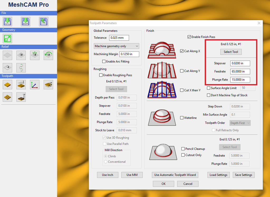

Next we need to make the toolpaths, for this I used the defaults setting for everything except the feeds and speed highlighted in the image:
I used a 1/8 Inch 2 fluted endmill. Select the right tool depending on what you have.
Note that I did not do a roughing pass as this is a very shallow form and so I directly did the finishing pass.
Click Ok and meshCAM will generate the toolpath.
Next click Save Toolpath and make sure to set the Save type as Basic Gcode-Inch if you are using an Xcarve to do the machining as highlighted in the images below.

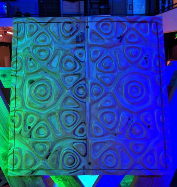

Step 3: CNC Cutting the Patterns
Make a few test cuts first to ensure you like the outcome, also try out different stains and oils to see what it will look like when completed before committing to do the full cut.
After this secure your material firmly to the Bed and make the Cut!
Make sure to pause the carving and to vacuum out all the saw dust every now and then.

Step 5: Sanding and Finishing.
Now that the X-carve has completed carving our pattern we need to sand away the burrs and toolmarks:
I used 120 Grit sand paper for this, it was effective at quickly sanding out all the burrs.
I quite liked the tool marks and so i decided to leave those be.
A process shot of the left side sanded.
After sanding we now need to apply some linseed oil to protect the plywood for outdoor use.
To do this I used a foam brush and applied 2 coats and let it absorb into the wood overnight.
The oil also helped bring out the grain to exaggerate the stripy patterns in the plywood.
