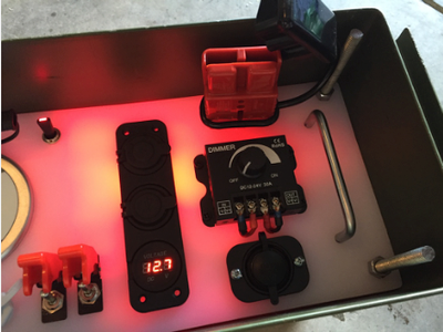

PROJECT UPDATE 9/12/16:
Well, my wife took it to the beach this Summer, and the steel plate panel rusted. While I was replacing the panel, I made some other updates to it. In particular:
- I replaced the steel panel with a poly cutting-board.
- I added a bus for the negative power to match the positive.
- I replaced the stand-alone USB and 12V jacks with an integrated USB / 12V / voltmeter.

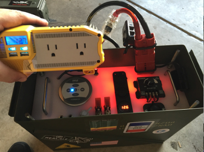

- I took the puny inverter off and added a connector for a 1500W inverter. Now I can run my microwave, fridge, and coffee maker.
- I changed the switches.
- I added a light to back-light the new panel.
- I added a 12v socket with a dimmer. Without the dimmer, my lights were too bright for some applications.
- I removed the fan. Didn't need it, and it took up too much room.

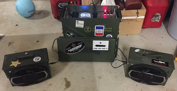

I call this project "Tactical Power Projection." The basic idea: a go-anywhere Swiss Army Knife of power, music, and lights. I can take this box to a campout, hunting lease, beach, night fishing, etc. and keep the lights on, keep the phones charged, and keep the tunes blasting all night. It's durable, water-proof, portable, and (I think) pretty cool looking.
I was very impressed with the Portable Sun Rechargeable Work Lamp and thought it would be cool to make one. About the time I started researching it, my 25-year-old boom box in the garage crapped out, so I started looking at 'build-your-own-speaker-systems' like this and this.
The idea came together to create a component system combining:
- A power supply
- An amplifier and speakers
- Spotlight and area lights
- Maybe a HAM radio (not installed yet)
I'm pretty happy with where the project is right now. I have a flexible portable power supply that can do anything I need to do for camping or for a temporary power outage. I also have a pretty damned loud stereo amplifier, with bluetooth and 3.5mm input. Finally, I can run lights all night. Plenty bright to work or to light up washer pits.
It will run 8 hours with lights and music, or over 30 hours with just music.
I still have things I want to do with it (rework the panel, add a HAM radio, 5.1 surround?, pico projector?..), but I'm also very happy with what it is now.

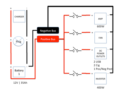

- Draw a circuit diagram.

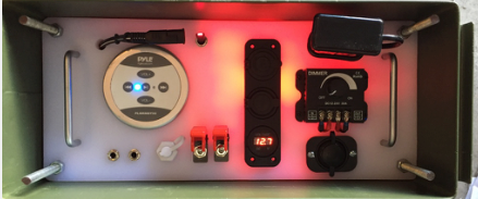

OK, a word about the interface panel. I built the prototype with thin wood, which you can see in the pictures. It was temporary, and it was flimsy once it had everything attached to it. I would recommend that you also prototype in wood, especially, to test / practice your cuts, dry run, etc.
I really like the metal look, and I'm thinking about keeping it. However, if I were to build it today, I would probably not use metal for the following reasons:
- It drove A LOT of extra time. Especially with the tools I have. If I do it with metal again, I'll have access to a laser cutter. With the tools listed in Step 1, it was time consuming to make big holes for the DC jacks, the 3.5MM jack, the inverter, and the amp controller. I would cut with the jigsaw, bend, grind, and file. Test it, cut it with snips, grind, and file some more.
- You have to insulate everything electronic that comes in contact with it. ESPECIALLY the speaker jacks. I have rubber washers insulating them now, which is an OK solution, but rubber is not durable. I also need to put some sort of rubber gasket on the inverter, or I'm going to get worried.
- It rusts.
I expect that I will do one of the following eventually:
- Keep the metal, but add a small wood panel for the speaker jacks. When I do that, I'll sand the rust off and paint it Olive Drab.
- Replace the metal with poly. I'm thinking a cutting board.
- Replace the metal with wood, stain it, make it look nice. This may be accompanied by a change to metal switches instead of the current plastic ones.

Step 8: Wire Power to the Components
I actually did this twice, so I'm going to try to combine lessons learned and tell you how to do it right the first time.
I ended up with a negative bus and a positive bus. A 'bus' is just a strip of metal that you use to connect different circuits to the battery. Please see the diagram. For my positive bus, I actually used a commercial bus strip. For the negative bus, I used a bolt and wrapped it up real good with tape. I'll replace this with another bus strip in the next version.
- First off, connect the positive bus to the positive (red) battery terminal using the red battery cable.
- Next, connect the negative bus to the negative (black) battery terminal using the black battery cable.
- Now, you should do one circuit at a time, in the following steps. Start with the fan, because it's cheap and easy to test.
- Strip the leads.
- Crimp the connectors.
- I used insulated female blade connectors for the end that attaches to the switch.
- I used loop connectors for the end that attaches to the bus.
- The lighted SPST switches I used have three connector posts: Positive, Negative, Acc.
- Use the inline fuse to connect the Positive post on the switch to the Positive bus. This connection should be: female blade terminal - wire - fuse holder (with fuse) - wire - loop terminal.
- Use a black wire to connect the Negative post on the switch to the Negative bus. This connection should be: female blade terminal - wire - loop terminal.
- Use a red wire to connect the Acc post on the switch to the Positive bus. This connection should be: female blade terminal - wire - loop terminal.
- Flip the switch and see what happens.
- If a fuse pops, or if the device doesn't come on, then you did something wrong. Go back, retrace everything, make sure there are no wires crossed, etc. Ask for help on forums.
- Pull the shrink-wrap over the connector and cook it with a lighter or heat gun. If you're using the insulated connectors, shrink-wrap over the sleeve of the connector. Your overall goal is to reduce exposed metal, reduce sparks, and improve strength of the connection.
- Put the shrink-wrap over the wire.
I ran a single DC circuit for the Binding Posts, USB, and 12VDC.
I did not put a switch on the inverter circuit - the inverter I used had a power switch already. As mentioned previously, I'm going to replace this inverter. When I do I'll add a switched circuit as described above.
I ended up with the following circuits:
- Fan (with a switch)
- Amp (with a switch)
- DC power (with a single switch for all three power methods)
- Inverter (no switch)
I also connected the vehicle charging attachment from the battery charger to the positive and negative bus, and looped it through a hole in the panel.

Step 9: Re-Work the Panel
OK, even if you're sticking with your prototype material (I couldn't - it was sagging), you'll probably want to move some stuff around. In my case, I rushed the prototype (a common strategy I use to get me working on a project instead of thinking about it) so I had some cleanup work to do.
I chose metal, and you can see in step 2 what I think about that. Having said that, here's how I updated the panel:
- Lay out where you want to put everything on your panel. What did you like / not like about the way the prototype was configured? What doesn't fit the way you thought it would?
- After you've decided on how you want it configured, trace the holes that you need to make.
- Make holes. :-) For the metal, the larger holes were a lot harder. I clamped it down and used a jigsaw for the larger holes. Then I would grind, file, grind, etc. until I had the right sized hole. WEAR GLOVES, EYE PROTECTION, and HEARING PROTECTION.
- Once again, I tended to test each item after I'd drilled or cut the hole.
Very similar to building the prototype panel, but you're working with metal now if you follow my approach.
As much of a pain in the butt it was to build, I think the metal looks good. :-)
Step 10: Make the Speakers and Wire the Amp
Since cutting the metal was so much fun, let's do some more!
Actually, cutting the ammo boxes isn't as bad as cutting the metal panel in the last step. The key thing with cutting ammo boxes is to stabilize the surface you're cutting.
For each speaker:
- First, print the template for your speaker, or cut it out from the box. Don't try to eyeball it. Use this template to mark the hole you're going to cut.
- Take the lid off of the ammo can. This is pretty easy - open the box and slide the lid to unhinge it. Set the lid aside for now.
- Clamp the box to your workbench, and create a lumber shim to keep the box from collapsing. The steel is not quite as strong as you'd think, especially after you cut a big hole in it. It will sag. Worse than that, it will vibrate with the saw. To prevent this vibration, we're going to prop up the surface that we're cutting. Wedge your 2-4 or other lumber into the box.
- Cut the hole. I used a drill to punch a pilot hole and then the jigsaw to complete the cutout.
- Drill the screw holes for the speaker.
- Drill a hole in the side of the ammo can for the speaker jack. I did mine on the hole opposite the handle / lid locking hardware, and that works pretty well.
- Drill a couple of dime-sized holes on the front of the speaker box. This is your speaker baffle, and makes the sound more full.
- Create a speaker wire harness to create the speakers to the jacks inside the boxes. The speaker jacks have very small connectors. I had a couple of really small (?) slide terminals, but I needed 8 total. I ended up crushing some other slide terminals to connect speakers to jacks.
- Attach the speakers and the jack.
- Loosely stuff some rags into the box, around the speaker. This helps keep the speakers from being 'tinny' from being inside of a metal box.
- Put the lid back on the ammo can.
- Put your cabinet stops (or glue rubber washers) under the ammo can handle. This prevents vibration at higher volumes.

Step 12: Take It Out and Play With It / Next Steps
Well, that's it. Now it's time to go out and take it for a spin.
Here are results from field testing:
- One charge = Over 30 hours at 50% volume. (Music only)
- One charge = Over 8 hours of light and 50% volume.
- My inverter is weak - I need to upgrade it. It will run my fan, but taps out on halogen lights. I'm probably going to go with 1000W.
- Plenty bright and plenty loud.
- Durable. I've taken it to a campout and a weekend-long fishing / washer pitching event. I take it out of the truck, plug it in, and it works. It's been knocked over, bounced around in my truck, and rained on (with the cover on it.) Works like a champ.
I'm very happy with how it worked out, and have been approached by several people asking me to make them one.

- Bigger inverter

Step 13: UPDATE: 9/12/16
Under Construction.
