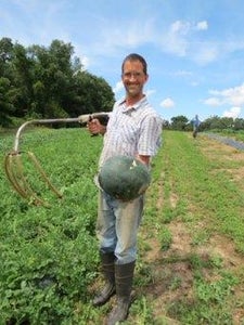

You say it is difficult to balance while lifting pumpkins from the ground to waist level? The pumpkin/squash lifter helps people who cannot bend down to pick up melons, squash, and other bulky items from the ground. It is built with conduit and pitchfork tines. It is a piece of ¾-inch metal conduit 36-inches long with a 6-inch bend in it. We spread the tines of a pitchfork wider and slightly up so the make a slight bowl shape. We slid rubber hose over the tines, so they are soft on the melons. The pitchfork tines are bolted into the conduit. An arm support handle is clamped on with hose clamps to give better control with one arm. It works very well picking up watermelons and cantaloupe. The handle can be lengthened, or the angles changed to make it more comfortable for individual workers. A cutter could be added on it for clipping the pumpkin vines in the future.

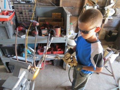

Step 1: Bend Tines
Clamp your pitch fork or refuse hook tightly, then heat and bend the edge tines outward so the tines form a basket shape to hold round objects from rolling off the side tines.

  1. Adjust the robo handle on the conduit with the tines facing toward you.
  2. Adjust the robo handle so you can comfortably grip it and lower the tines to the ground without bending over.
  3. Walk to the melon or squash or pumpkin needed.
  4. Lower tines to the ground and nudge the melon onto the tines with your toe.
  5. Lift the melon to waist height and remove it from the tines with your other hand or carry it to the crate.
