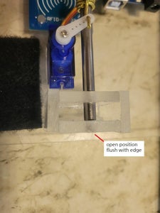

Step 5: Cut and Shape Locking Pin
The pin is just that, a pin. This pin is about 3 inches long and is polished very smooth. The end that is closest to the edge of the plexiglas has a very slight chamfer sanded into it. I found out the hard way that if you clamp the pin in a vice it will slightly deform the pin making is bind in the tabs that you will install next. make sure the pin is as smooth and burr free as possible. This pin is a bit longer than you need and you may end up trimming it down a bit later. Better a bit to long.
Step 6: Install Locking Pin Tabs
This part was by far the most fiddly bit of the whole project. You will need to cut two tabs that are exactly identical. I suggest that you make the tabs about an inch wide and about 3 inches long. This is much larger than they need to be, but it is very important that the holes that are drilled in the tabs for the pin to pass through are aligned perfectly. A slightly oversized tab allows you to drill the holes while the two tabs are clamped together. Then trim the tabs together to make them the exact same. See the pictures for what I mean.
Using the acrylic cement attach the first tab about 1/4 back from the right edge of the lid. make sure it is straight and square with the edge. When the cement has dried install the pin in the attached first tab and slide the second tab over the pin and bring it up behind the first with a gap of about 3/8 inch. Test slide the pin back and fourth and feel for a smooth almost effortless movement of the pin. Once you have the correct position of the second tab apply the acrylic cement and hold all three pieces in place for at least a minute to make sure nothing shifts. Once the cement dries gently test the pin and see if it still slides smooth. If it doesn't, allow the glue to set fully for a good 5 minutes before disturbing the pin. When the time is up gently remove the pin and re-insert the drill bit that you used to drill the holes and with finger power only slowly rotate the bit to take any burrs off and trim the edge of the hole. Test the pin now occasionally to test the sliding. When you are satisfied that the pin moves freely, then cut and bond the two side pieces of the of the tabs to add stability. (see pictures)
Take your time here. Be very patient. Go slow. It will save you much swearing and airborne tools.
Step 7: Attach the Servo
As you can see there is a brass wire wrapped around the pin. This is how I made the attachment to the pin. After tightly wrapping the brass wire around the pin it was bent to attach to the servo. The coil wrapped around the pin was still a bit loose so adjustment was still possible. Align the servo up and with a couple of drops of super glue, attach the servo to the plexiglas. Once the servo is attached, make adjustments so that when the servo horn is straight to the side the pin sticks out of the edge tab about 1/8 inch. Once you have it adjusted put a drop or two of super glue on the coil to attach the coil to the pin. Allow a good long set for this glue before you test the servo.
Do not rush this one either. I glued the pin to the tab because I rushed it. Walk away, have a coffee then come back
