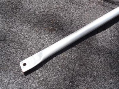

Next, take a hammer and flatten one end of each conduit piece as shown in the picture.
Finally, drill a hole through the flattened end. The size of the hole should be just wide enough to allow your bolts to pass through. The size of the bolt is determined by the size of the holes in the "L" brackets (Step 4) and the holes along the power jacks.

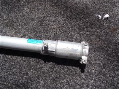

Step 3: Adding the Grippers
The larger diameter rod needs a way to grab onto the smaller diameter rod. This can be accomplished by a series of conduit pipe fittings. I played around with various pieces until I found something worked. See the above images for the pieces I used.
The first piece slides over the end of the larger diameter rod and has a threaded end. The second piece is a coupler to connect the first and third threaded pieces. The third piece has one threaded end while the other can be tightened down around the smaller diameter rod.
I used RV Goop to glue each of the pieces together. It may be beneficial to not attach the gripper to the larger diameter rod until after you complete Step 4 - Attaching the Top 4 L-Brackets. This way, you can hold the rod up to the bracket and determine the best orientation of the gripper pieces on the rod to allow easy access to the tightening screws at the end of piece 3.

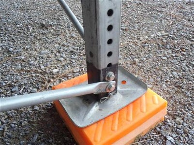

Step 5: Attach the Smaller Diameter Rods
The 4 smaller diameter rods will be attached to the front power jacks. This is why the jacks need to have holes down the sides. Ours have manually lowering feet so the jacks don't have to be lowered so far, and the holes are there for the catch pin. Because our holes run through the jack legs from side to side, the two side rods can be blot directly to the legs; however, the two front rods will need to be attached to the other two L-brackets which can be bolted directly to the legs.
The L-brackets need to be bolted tightly to the legs, but the rods need to be able to pivot as the jack legs are raised and lowered. This is where the lock nuts come in handy. They don't need to be tightened all the way, just enough that the rods don't have much play room but are still allowed to pivot.
