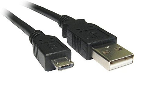

A micro USB cable is required for programming and powering this project, I'm going to assume you already have one as they come with everything! Nearly all Android phones came with them for the last few years, check the second image if you are not sure which type of cable is micro USB.

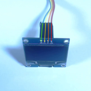

Step 6: Wiring Up the Display
Note: Unplug USB cable from the ESP8266 before starting this step, just to be on the safe side.
The screen should be wired up to the as follows:
Display Pins -> NodeMCU board
GND -> G
VCC -> 3V
SCL(or SCK) -> D5
SDA -> D3
If you are finding the table above hard to follow, check out the pictures above.
WARNING! I have seen online that sometimes these displays have a the GND and VCC pins the other way around from my diagram, make sure that you always connect GND to G and VCC to 3V or you may damage your display

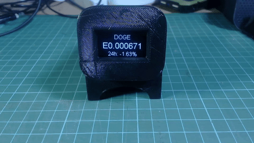

Step 8: A Stand - the Right Way
Now we will need a stand to hold our masterpiece. I'll show two different options for this.
This way would be the more professional way. I made up a case to be printed out on a 3d printer. I am pretty terrible at 3d design, but I did my best!
You can find the files here.
Check the gifs out above for assembly, but its pretty straight forward (although i did use blu tack, aka sticky tack, to hold it all together)
