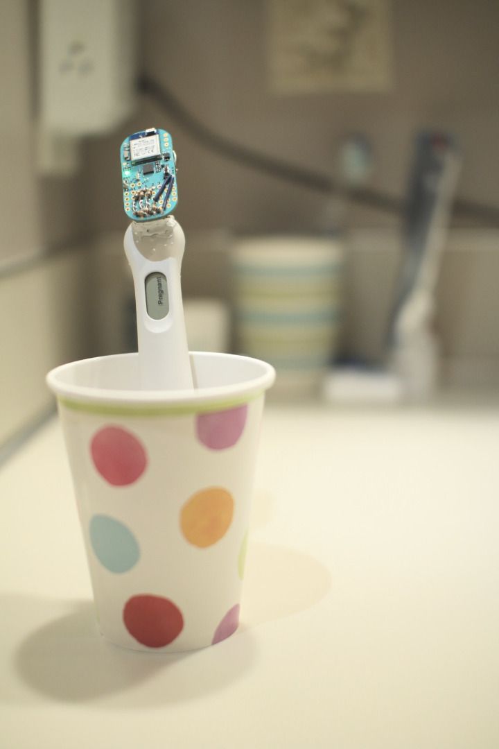

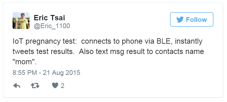

The project idea came from this tongue-in-cheek twitter post. But hey, why not try to make one? I read somewhere that the world needs more ridiculous smart devices. So here it is.

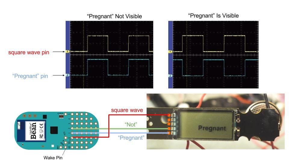

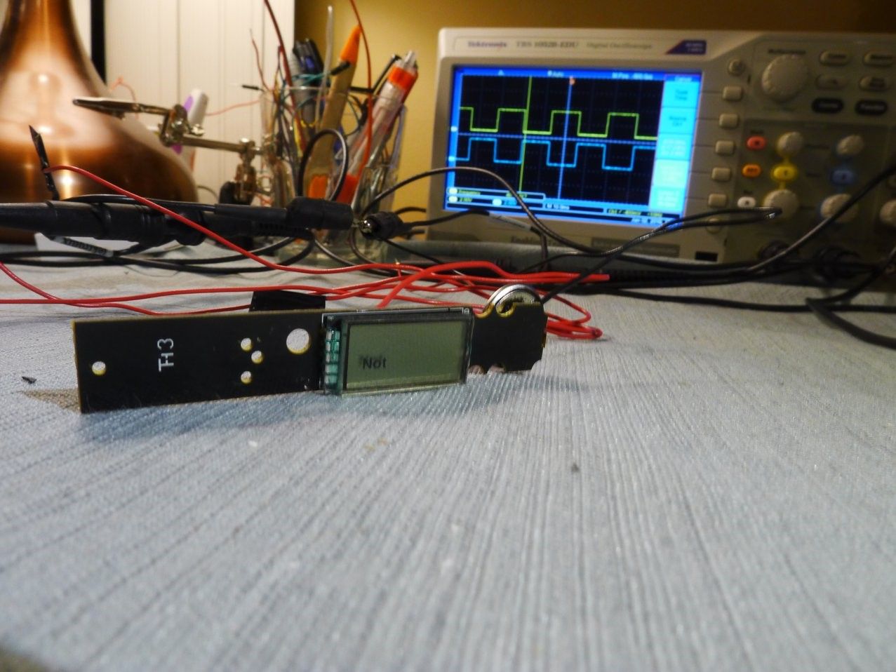

The disco mode was pretty handy for figuring out which pin on the LCD displays which icon. I was kind of naive thinking that a high level on a particular LCD pin turns on a particular icon. I learned that LCDs don't work like LEDs, they need to be driven by an AC signal.
Source: http://www.lxdinc.com/application_notes/lcd_direc...
The pins that are easily accessible on the pregnancy test LCD are on the output of the XOR. So when the icon is on, that pin sees the half cycle phase shifted output relative to the regular "clock" waveform. With the unit in disco mode, it was easy to identify the clock pin (A) as well as the individual icon pins (C).
From this, I can see that when the icon pin is in phase with the clock pin, that icon is not being displayed.
However, if the icon pin is not in phase with the clock pin, the icon is being displayed, like the condition below.

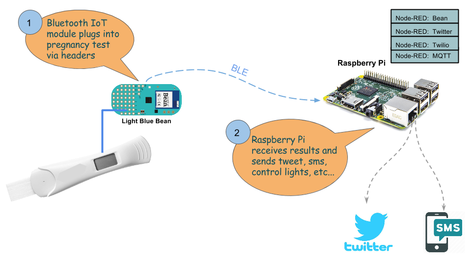

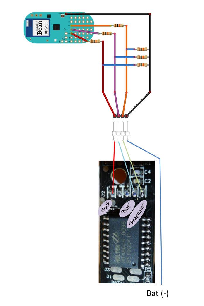

Since I only intend to monitor the "Not" and the "Pregnant" icons, I only need 4 wires: Not, Pregnant, Clock, and Ground. I'm using a Light Blue Bean for the microcontroller, which also has a Bluetooth Low Energy transceiver.

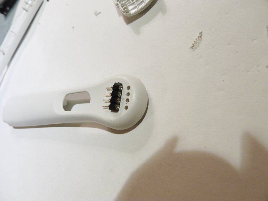

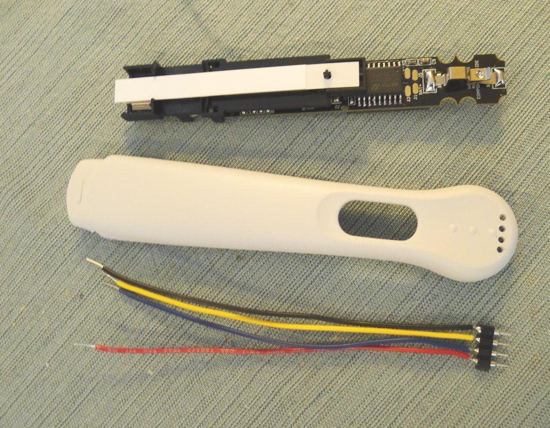

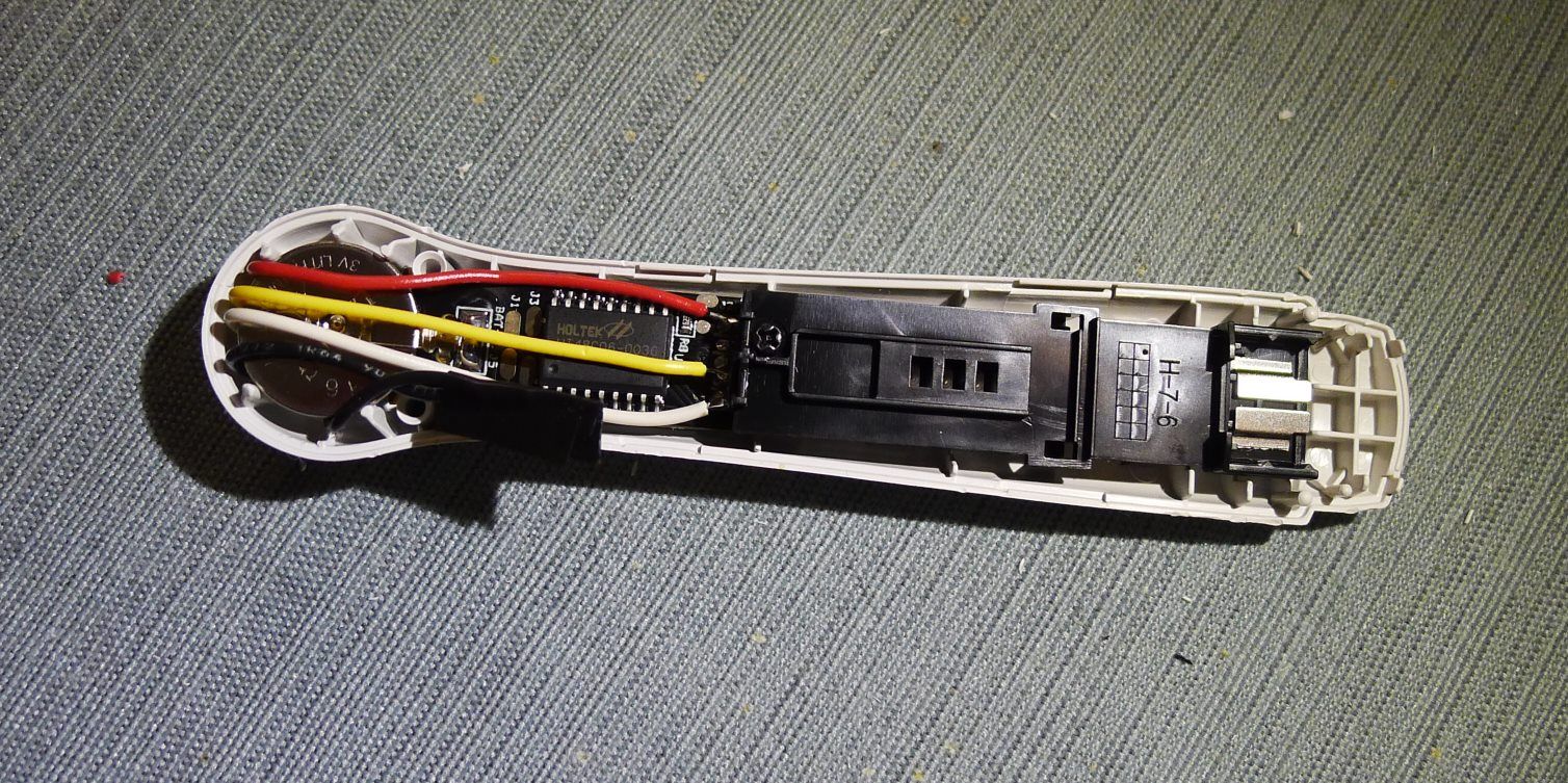

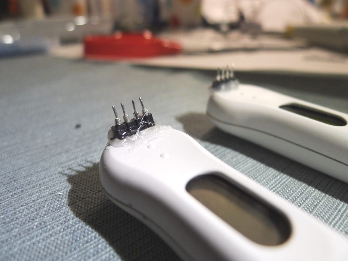

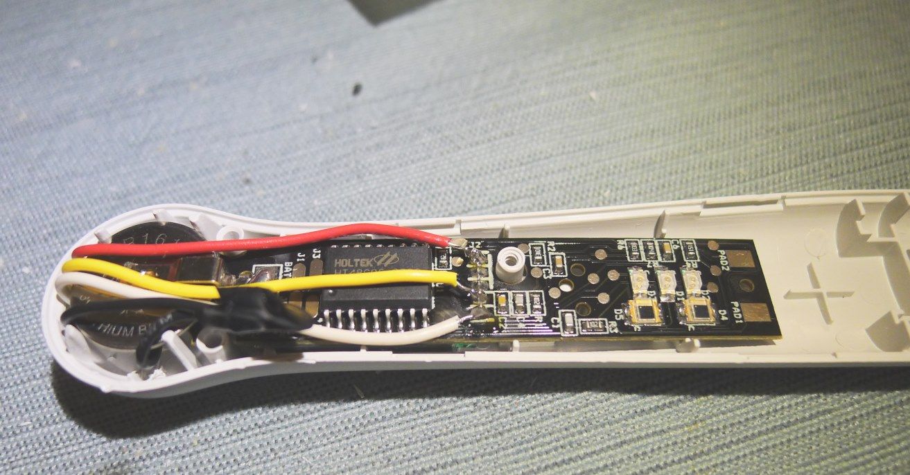

Now that we know which pins we want to bring out of the pregnancy test, we need to solder the pins and wire them up to headers.
1. Drill holes into the top of the pregnancy test for the headers pins.
2. Solder 26 AWG wire to the headers.
3. Pull the wires through the holes and solder them onto the LCD pins found in previous step.

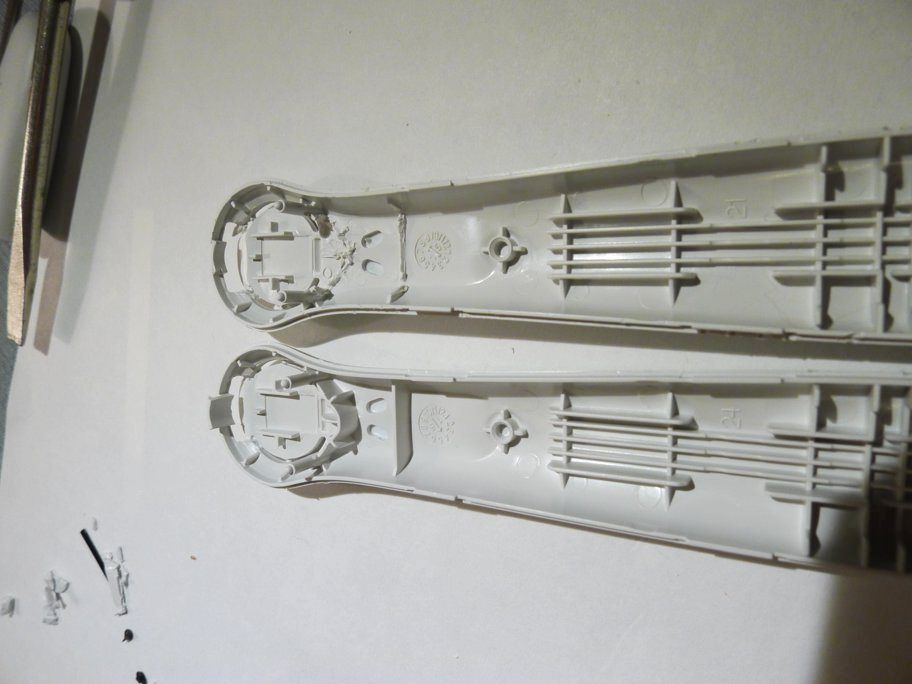

4. Reassemble the components. Cut the little bit of plastic above the LCD pins so that the wires aren't pinched.
5. Cut away more plastic on the other half of the shell to accommodate the wires.
6. Put it all together. Use hot glue to attach the headers in place.

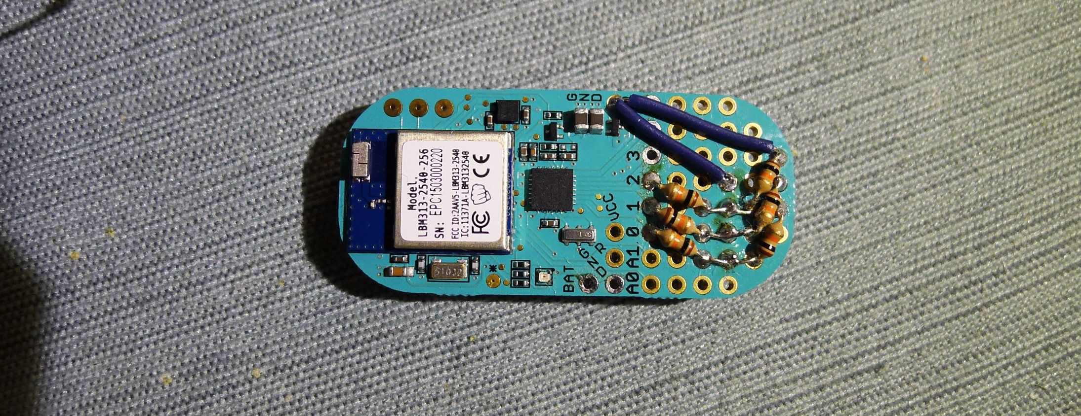

The pregnancy test attaches to headers on the Light Blue Bean. The circuit above shows how it's wired up. The resistors on the ground are pull down resistors and the resistors on the I/O pin prevent too much current flowing back in case the Bean's battery is left out when attached to a powered pregnancy test. I used 1/8W 10k Ohm resistors so they fit nicely on the prototype area of the Bean.
To preserve power, the Bean is sleeping most of the time. Pin 0 on the Bean (connected to the clock pin on the LCD) is set as the interrupt to wake the Bean from sleep. When the test is not being used, there is no signal on the clock pin. When the test is activated, the LCD starts displaying the hourglass icon, and the clock pin is driven with the 40Hz square wave. This wakes it up.

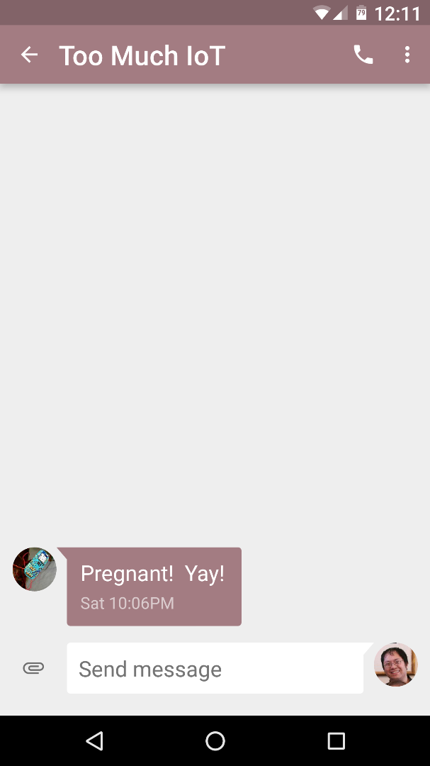

- Result: Once the result is read, the data is sent via the Bean Serial to the Raspberry Pi for social media consumption. The LED also changes state. A solid red means not pregnant, solid green means pregnant.(4) Sleep: The Bean goes to sleep 8 seconds after it's unplugged. LED goes dark. The Bean module can be removed and snapped onto another test over and over again.

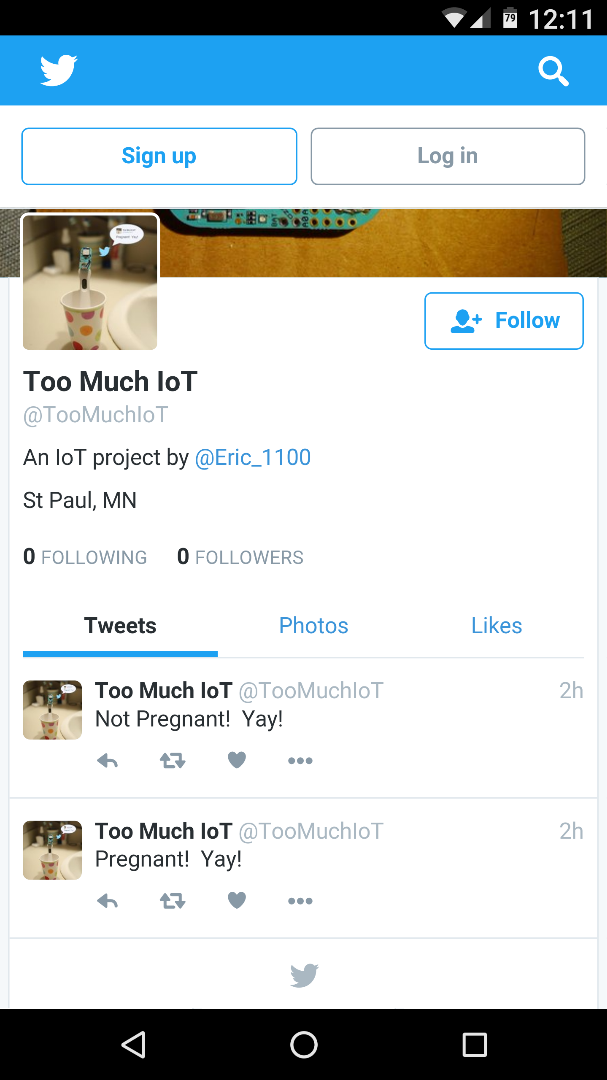

The Bluetooth LE (Bean) communicates with the Raspberry Pi via a USB bluetooth adapter. I'm using NodeRED to receive the Bluetooth data, and then Twilio and Tweeter nodes to send text messages and tweet. See above for the small bits of code for each node.
I happen to have some lights that are controlled via MQTT and OpenHAB. In the demo video, you can see the table lamp turn on when the result is "Pregnant". The lamp turns off when it's "Not Pregnant". The function looks like it's not doing anything, but it is necessary due to some oddities with OpenHAB not catching MQTT publishes without \n. The arrangement of makes it easy to visually exclude messages from different services.
Step 6: Tweet
In other news, my wife and I are really excited to be expecting our second child later this year :)
